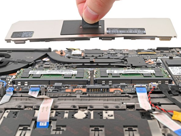

  7. Lenovo ThinkPad T16 Gen 3 RAM Replacement, Remove the RAM shield: crwdns2935265:07crwdnd2935265:01crwdnd2935265:02crwdne2935265:0 Lenovo ThinkPad T16 Gen 3 RAM Replacement, Remove the RAM shield: crwdns2935265:07crwdnd2935265:02crwdnd2935265:02crwdne2935265:0
    • Grab the pull tab in the middle of the RAM shield and pull straight up to remove it from its clips.
    • Since the RAM shield is thin, it may bend slightly during removal. During reassembly, lay the shield into place and press down firmly around the perimeter to engage all the clips.

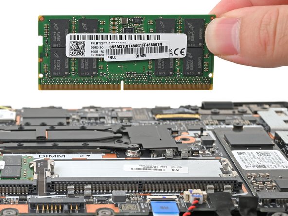

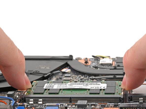

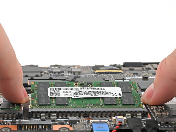

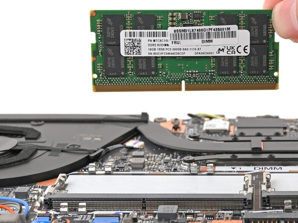

  8. Lenovo ThinkPad T16 Gen 3 RAM Replacement, Remove the RAM: crwdns2935265:08crwdnd2935265:01crwdnd2935265:03crwdne2935265:0 Lenovo ThinkPad T16 Gen 3 RAM Replacement, Remove the RAM: crwdns2935265:08crwdnd2935265:02crwdnd2935265:03crwdne2935265:0 Lenovo ThinkPad T16 Gen 3 RAM Replacement, Remove the RAM: crwdns2935265:08crwdnd2935265:03crwdnd2935265:03crwdne2935265:0
    • Use your fingers to simultaneously push the two metal tabs on the edges of the RAM module down and outwards to unlatch them—the RAM should pop up at a slight angle.
    • Remove the RAM module.
  9. Lenovo ThinkPad T16 Gen 3 RAM Replacement: crwdns2935265:09crwdnd2935265:01crwdnd2935265:03crwdne2935265:0 Lenovo ThinkPad T16 Gen 3 RAM Replacement: crwdns2935265:09crwdnd2935265:02crwdnd2935265:03crwdne2935265:0 Lenovo ThinkPad T16 Gen 3 RAM Replacement: crwdns2935265:09crwdnd2935265:03crwdnd2935265:03crwdne2935265:0
    • Repeat the process for the other RAM module.
    • During reassembly, fully insert the RAM at the angle it popped up at, then press down to engage the metal arms.
