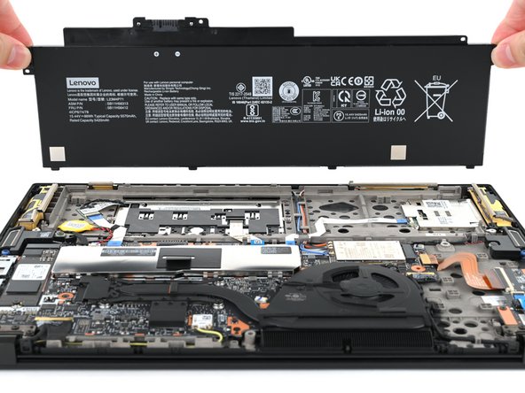

  12. Lenovo ThinkPad T16 Gen 3 Motherboard Replacement, Loosen the battery screws: crwdns2935265:012crwdnd2935265:01crwdnd2935265:02crwdne2935265:0 Lenovo ThinkPad T16 Gen 3 Motherboard Replacement, Loosen the battery screws: crwdns2935265:012crwdnd2935265:02crwdnd2935265:02crwdne2935265:0
    • Because of the battery connector's design, the only way to disconnect the battery is by physically removing it.
    • Use a Phillips screwdriver to fully loosen the two captive screws securing the battery connector.
  13. Lenovo ThinkPad T16 Gen 3 Motherboard Replacement, Remove the battery: crwdns2935265:013crwdnd2935265:01crwdnd2935265:03crwdne2935265:0 Lenovo ThinkPad T16 Gen 3 Motherboard Replacement, Remove the battery: crwdns2935265:013crwdnd2935265:02crwdnd2935265:03crwdne2935265:0 Lenovo ThinkPad T16 Gen 3 Motherboard Replacement, Remove the battery: crwdns2935265:013crwdnd2935265:03crwdnd2935265:03crwdne2935265:0
    • Lift the edge of the battery with the connector to disconnect it.
    • You may feel a little resistance from the battery connector as it disconnects—that's normal.
    • Remove the battery
    • During reassembly:
    • Slide the plastic tabs on the long edge of the battery into their recesses in the frame.
    • Lower the battery into place so the connector goes over its socket.

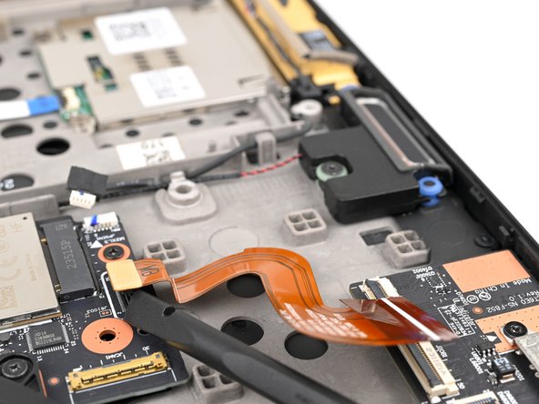

  21. Lenovo ThinkPad T16 Gen 3 Motherboard Replacement, Disconnect the interconnect cable: crwdns2935265:021crwdnd2935265:01crwdnd2935265:03crwdne2935265:0 Lenovo ThinkPad T16 Gen 3 Motherboard Replacement, Disconnect the interconnect cable: crwdns2935265:021crwdnd2935265:02crwdnd2935265:03crwdne2935265:0 Lenovo ThinkPad T16 Gen 3 Motherboard Replacement, Disconnect the interconnect cable: crwdns2935265:021crwdnd2935265:03crwdnd2935265:03crwdne2935265:0
    • Use a clean fingernail or the flat end of a spudger to flip up the locking flap on the I/O board interconnect cable connector.
    • Use tweezers or your fingers to gently pull the cable by its pull tab out of its socket.
  22. Lenovo ThinkPad T16 Gen 3 Motherboard Replacement, Remove the interconnect cable: crwdns2935265:022crwdnd2935265:01crwdnd2935265:03crwdne2935265:0 Lenovo ThinkPad T16 Gen 3 Motherboard Replacement, Remove the interconnect cable: crwdns2935265:022crwdnd2935265:02crwdnd2935265:03crwdne2935265:0 Lenovo ThinkPad T16 Gen 3 Motherboard Replacement, Remove the interconnect cable: crwdns2935265:022crwdnd2935265:03crwdnd2935265:03crwdne2935265:0
    • Insert the flat end of a spudger or a clean fingernail under a short edge of the interconnect cable press connector (located on the motherboard) and pry up to disconnect it.
    • Remove the interconnect ribbon cable from the laptop.

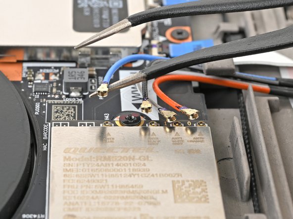

  29. Lenovo ThinkPad T16 Gen 3 Motherboard Replacement, Disconnect the antenna cables: crwdns2935265:029crwdnd2935265:01crwdnd2935265:03crwdne2935265:0 Lenovo ThinkPad T16 Gen 3 Motherboard Replacement, Disconnect the antenna cables: crwdns2935265:029crwdnd2935265:02crwdnd2935265:03crwdne2935265:0 Lenovo ThinkPad T16 Gen 3 Motherboard Replacement, Disconnect the antenna cables: crwdns2935265:029crwdnd2935265:03crwdnd2935265:03crwdne2935265:0
    • Insert one arm of your angled tweezers under the metal neck of one of the antenna coaxial connectors on the WWAN card and lift straight up to disconnect it.
  30. Lenovo ThinkPad T16 Gen 3 Motherboard Replacement: crwdns2935265:030crwdnd2935265:01crwdnd2935265:03crwdne2935265:0 Lenovo ThinkPad T16 Gen 3 Motherboard Replacement: crwdns2935265:030crwdnd2935265:02crwdnd2935265:03crwdne2935265:0 Lenovo ThinkPad T16 Gen 3 Motherboard Replacement: crwdns2935265:030crwdnd2935265:03crwdnd2935265:03crwdne2935265:0
    • Repeat the process to disconnect the remaining antenna cables from the WWAN card.
    • During reassembly, use tweezers to hold each connector in place over its socket and gently press down with your finger or a spudger—the connector should "snap" into place. If you're having trouble, reposition the head instead of using more force.
  31. Lenovo ThinkPad T16 Gen 3 Motherboard Replacement, Free the antenna cables: crwdns2935265:031crwdnd2935265:01crwdnd2935265:03crwdne2935265:0 Lenovo ThinkPad T16 Gen 3 Motherboard Replacement, Free the antenna cables: crwdns2935265:031crwdnd2935265:02crwdnd2935265:03crwdne2935265:0 Lenovo ThinkPad T16 Gen 3 Motherboard Replacement, Free the antenna cables: crwdns2935265:031crwdnd2935265:03crwdnd2935265:03crwdne2935265:0
    • Hold all the antenna cables together and guide them out of their clip on the chassis.
