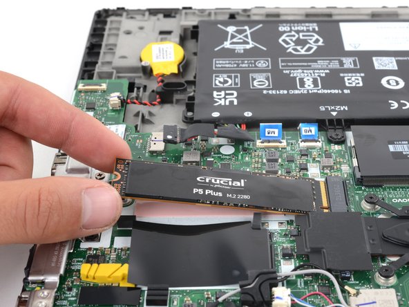

  9. Lenovo ThinkPad T15 Gen 2 SSD Replacement, Unfasten the SSD: crwdns2935265:09crwdnd2935265:01crwdnd2935265:02crwdne2935265:0 Lenovo ThinkPad T15 Gen 2 SSD Replacement, Unfasten the SSD: crwdns2935265:09crwdnd2935265:02crwdnd2935265:02crwdne2935265:0
    • Use a Phillips screwdriver to remove the 3.5 mm screw securing the SSD.
  10. Lenovo ThinkPad T15 Gen 2 SSD Replacement, Remove the SSD: crwdns2935265:010crwdnd2935265:01crwdnd2935265:03crwdne2935265:0 Lenovo ThinkPad T15 Gen 2 SSD Replacement, Remove the SSD: crwdns2935265:010crwdnd2935265:02crwdnd2935265:03crwdne2935265:0 Lenovo ThinkPad T15 Gen 2 SSD Replacement, Remove the SSD: crwdns2935265:010crwdnd2935265:03crwdnd2935265:03crwdne2935265:0
    • Pull the SSD out of its socket and remove it. Keep the SSD as parallel to the motherboard as possible when pulling on it.
    • Do not pull up at a sharp angle, as this could damage the SSD and the socket.
