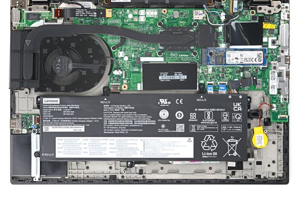

  8. Lenovo ThinkPad T15 Gen 2 Battery Replacement, Disconnect the battery: crwdns2935265:08crwdnd2935265:01crwdnd2935265:03crwdne2935265:0 Lenovo ThinkPad T15 Gen 2 Battery Replacement, Disconnect the battery: crwdns2935265:08crwdnd2935265:02crwdnd2935265:03crwdne2935265:0 Lenovo ThinkPad T15 Gen 2 Battery Replacement, Disconnect the battery: crwdns2935265:08crwdnd2935265:03crwdnd2935265:03crwdne2935265:0
    • Grip the pull tab on the battery connector with your fingers and gently pull away from the socket to disconnect it.
  9. Lenovo ThinkPad T15 Gen 2 Battery Replacement, Unfasten the battery: crwdns2935265:09crwdnd2935265:01crwdnd2935265:02crwdne2935265:0 Lenovo ThinkPad T15 Gen 2 Battery Replacement, Unfasten the battery: crwdns2935265:09crwdnd2935265:02crwdnd2935265:02crwdne2935265:0
    • Use a Phillips #0 screwdriver to remove the three 5.4 mm-long screws securing the battery.
  10. Lenovo ThinkPad T15 Gen 2 Battery Replacement, Remove the battery: crwdns2935265:010crwdnd2935265:01crwdnd2935265:03crwdne2935265:0 Lenovo ThinkPad T15 Gen 2 Battery Replacement, Remove the battery: crwdns2935265:010crwdnd2935265:02crwdnd2935265:03crwdne2935265:0 Lenovo ThinkPad T15 Gen 2 Battery Replacement, Remove the battery: crwdns2935265:010crwdnd2935265:03crwdnd2935265:03crwdne2935265:0
    • Push the battery toward the top of the laptop to release its plastic clips.
    • Lift the battery straight out of its recess and remove it.
