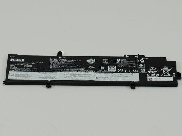

    • Use a JIS #1 screwdriver to remove six M2 x 5 mm screws that hold the battery in place.
    • There is a risk to your laptop if the battery is not discharged properly.
  3. Lenovo ThinkPad T14 Gen 3 SSD Replacement: crwdns2935265:03crwdnd2935265:01crwdnd2935265:03crwdne2935265:0 Lenovo ThinkPad T14 Gen 3 SSD Replacement: crwdns2935265:03crwdnd2935265:02crwdnd2935265:03crwdne2935265:0 Lenovo ThinkPad T14 Gen 3 SSD Replacement: crwdns2935265:03crwdnd2935265:03crwdnd2935265:03crwdne2935265:0

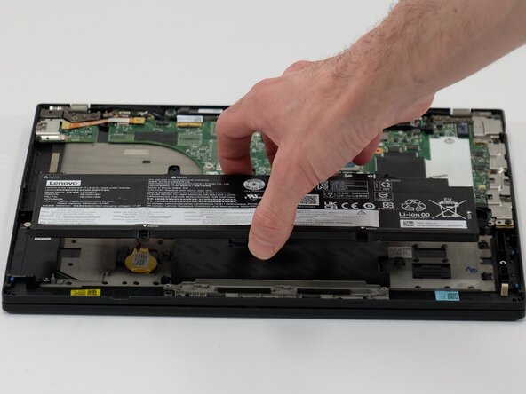

    • Slide the battery from the battery connector and remove it.

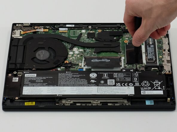

    • Use a JIS #1 screwdriver to remove the single screw securing the SSD. As seen circled here opposite of the connector.
    • Put the screw somewhere safe to use for the replacement SSD.

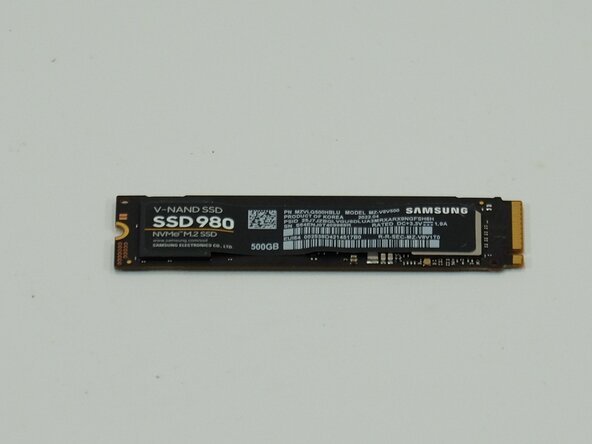

  5. Lenovo ThinkPad T14 Gen 3 SSD Replacement: crwdns2935265:05crwdnd2935265:01crwdnd2935265:02crwdne2935265:0 Lenovo ThinkPad T14 Gen 3 SSD Replacement: crwdns2935265:05crwdnd2935265:02crwdnd2935265:02crwdne2935265:0
    • Place your fingers on either side of the card near the port, and gently pull it straight out.
    • Be careful not to use too much pressure or bend the card
