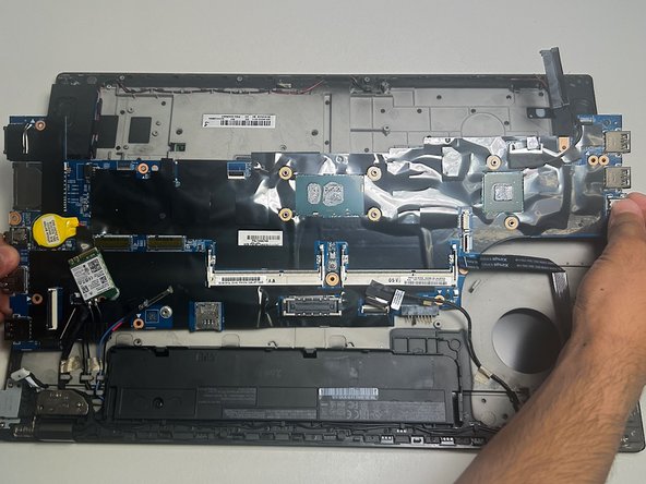

    • Use a Phillips #00 screwdriver to remove the five 2.5 mm screws securing the motherboard to the chassis.
  25. Lenovo ThinkPad P50s Motherboard Replacement: crwdns2935265:025crwdnd2935265:01crwdnd2935265:03crwdne2935265:0 Lenovo ThinkPad P50s Motherboard Replacement: crwdns2935265:025crwdnd2935265:02crwdnd2935265:03crwdne2935265:0 Lenovo ThinkPad P50s Motherboard Replacement: crwdns2935265:025crwdnd2935265:03crwdnd2935265:03crwdne2935265:0

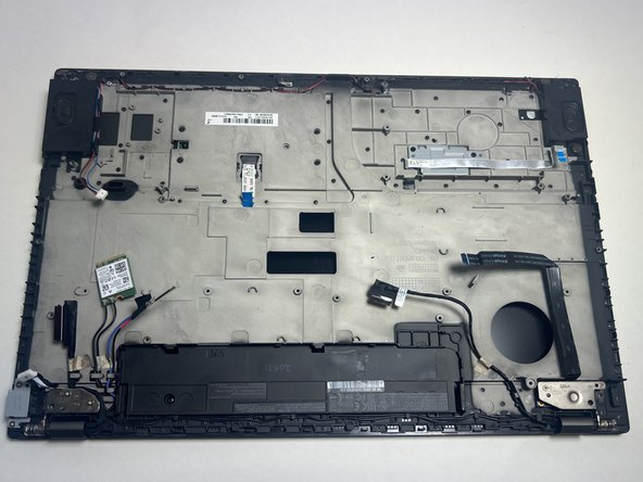

    • Remove the motherboard from the laptop.
To reassemble your device, follow these instructions in reverse order. Take your e-waste to an R2 or e-Stewards certified recycler.
