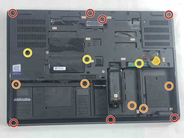

  2. Lenovo ThinkPad P50 Keyboard Bezel/Trackpad Assembly, Bottom case screws: crwdns2935265:02crwdnd2935265:01crwdnd2935265:01crwdne2935265:0
    • Loosen the six 12.6 mm captive screws that secure the lower case with the Phillips #00 screwdriver.
    • The screws will not come all the way out; do not attempt to remove them from the case.
    • Pull up the notch with your fingernail or a spudger.
  3. Lenovo ThinkPad P50 Keyboard Bezel/Trackpad Assembly, Bottom case: crwdns2935265:03crwdnd2935265:01crwdnd2935265:02crwdne2935265:0 Lenovo ThinkPad P50 Keyboard Bezel/Trackpad Assembly, Bottom case: crwdns2935265:03crwdnd2935265:02crwdnd2935265:02crwdne2935265:0
    • Lift the lower case up and off of the chassis.
  4. Lenovo ThinkPad P50 Keyboard Bezel/Trackpad Assembly, Trackpad: crwdns2935265:04crwdnd2935265:01crwdnd2935265:02crwdne2935265:0 Lenovo ThinkPad P50 Keyboard Bezel/Trackpad Assembly, Trackpad: crwdns2935265:04crwdnd2935265:02crwdnd2935265:02crwdne2935265:0
    • Remove the following screws with a Phillips #00 screwdriver:
    • Seven 5.7 mm screws
    • Five 4.3 mm screws
    • Three 12.6 mm screws

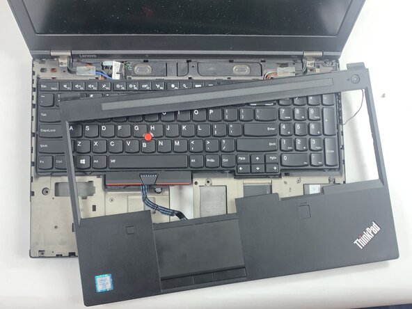

  5. Lenovo ThinkPad P50 Keyboard Bezel/Trackpad Assembly: crwdns2935265:05crwdnd2935265:01crwdnd2935265:02crwdne2935265:0 Lenovo ThinkPad P50 Keyboard Bezel/Trackpad Assembly: crwdns2935265:05crwdnd2935265:02crwdnd2935265:02crwdne2935265:0

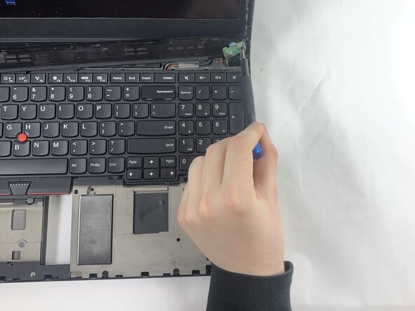

    • Turn the computer over and open the lid.
    • Insert an opening pick in the seam between the keyboard bezel and chassis.
    • Pry around the entire perimeter until the keyboard assembly fully releases.

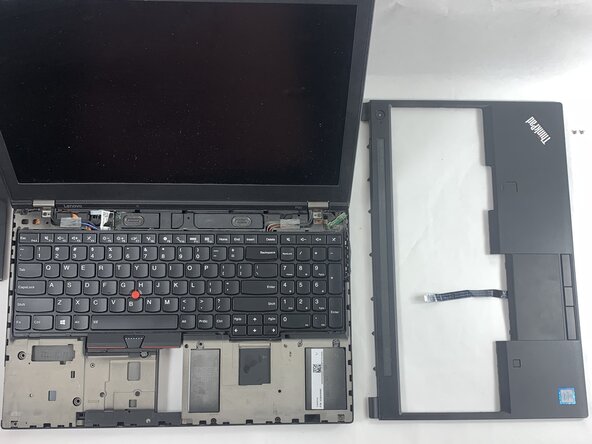

  6. Lenovo ThinkPad P50 Keyboard Bezel/Trackpad Assembly: crwdns2935265:06crwdnd2935265:01crwdnd2935265:03crwdne2935265:0 Lenovo ThinkPad P50 Keyboard Bezel/Trackpad Assembly: crwdns2935265:06crwdnd2935265:02crwdnd2935265:03crwdne2935265:0 Lenovo ThinkPad P50 Keyboard Bezel/Trackpad Assembly: crwdns2935265:06crwdnd2935265:03crwdnd2935265:03crwdne2935265:0
    • Pivot the keyboard further up until you can see the connectors on the underside of the keyboard
    • Detach the connectors that connect to the trackpad.
    • Most of the time, these connectors will have a lip or a tab along the top that can be used to push the connector out of its socket.
    • To disconnect, use the wide end of a spudger to push on the connector tab to slide it out of its socket.
    • It may take a lot of force to disconnect the cable. Go slowly, and don't pull on the cables.
