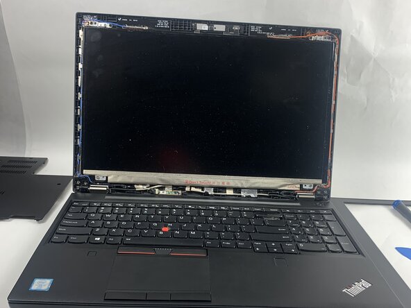

  4. Lenovo ThinkPad P50 Display Replacement, Display: crwdns2935265:04crwdnd2935265:01crwdnd2935265:02crwdne2935265:0 Lenovo ThinkPad P50 Display Replacement, Display: crwdns2935265:04crwdnd2935265:02crwdnd2935265:02crwdne2935265:0
    • Use an iFixit opening pick to carefully remove the plastic bezel from the front of the display.
    • There are clips beneath the trim that need to be carefully detached.
    • Avoid using metal tools, as they can damage the plastic components.

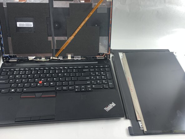

  5. Lenovo ThinkPad P50 Display Replacement: crwdns2935265:05crwdnd2935265:01crwdnd2935265:01crwdne2935265:0
    • Remove the four 2.5 mm screws located along the corners with a Phillips #00 screwdriver.
  6. Lenovo ThinkPad P50 Display Replacement: crwdns2935265:06crwdnd2935265:01crwdnd2935265:03crwdne2935265:0 Lenovo ThinkPad P50 Display Replacement: crwdns2935265:06crwdnd2935265:02crwdnd2935265:03crwdne2935265:0 Lenovo ThinkPad P50 Display Replacement: crwdns2935265:06crwdnd2935265:03crwdnd2935265:03crwdne2935265:0

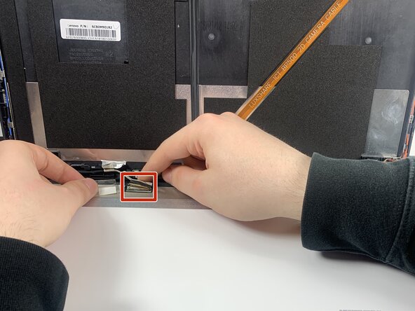

    • Carefully tilt the screen forward and lay it face down on the keyboard, making sure not to strain or damage the cable still attached to it.
    • Display (sometimes called eDP cables in laptops) and camera cable connectors often have a small metal buckle running around the socket, locking them in place. The connectors are typically wide and may have tape attached to the buckle.
    • Gently push the tip of a spudger under the metal buckle to unclip it, then swing it over the socket.
    • Hold the buckle and cable together and gently pull the connector straight out of its socket.
