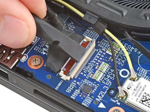

  12. Lenovo ThinkPad P1 Gen 7 Screen Replacement, Disconnect the screen: crwdns2935265:012crwdnd2935265:01crwdnd2935265:03crwdne2935265:0 Lenovo ThinkPad P1 Gen 7 Screen Replacement, Disconnect the screen: crwdns2935265:012crwdnd2935265:02crwdnd2935265:03crwdne2935265:0 Lenovo ThinkPad P1 Gen 7 Screen Replacement, Disconnect the screen: crwdns2935265:012crwdnd2935265:03crwdnd2935265:03crwdne2935265:0

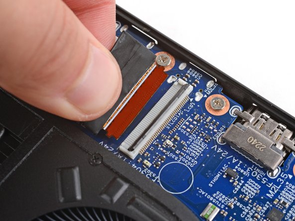

    • Use the flat end of a spudger to lift the locking flap on the screen cable ZIF connector near the right edge of your laptop.
    • Use your fingers to grip the screen cable and gently pull the connector out of its socket.

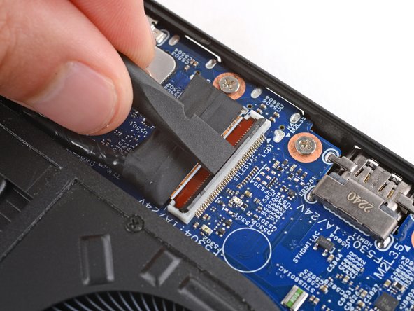

  13. Lenovo ThinkPad P1 Gen 7 Screen Replacement: crwdns2935265:013crwdnd2935265:01crwdnd2935265:03crwdne2935265:0 Lenovo ThinkPad P1 Gen 7 Screen Replacement: crwdns2935265:013crwdnd2935265:02crwdnd2935265:03crwdne2935265:0 Lenovo ThinkPad P1 Gen 7 Screen Replacement: crwdns2935265:013crwdnd2935265:03crwdnd2935265:03crwdne2935265:0

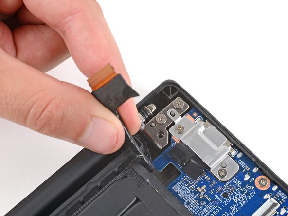

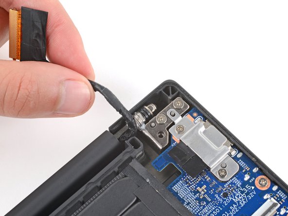

    • Carefully guide the right screen-cable out from under its cutout in the motherboard, near the right hinge.
  14. Lenovo ThinkPad P1 Gen 7 Screen Replacement: crwdns2935265:014crwdnd2935265:01crwdnd2935265:03crwdne2935265:0 Lenovo ThinkPad P1 Gen 7 Screen Replacement: crwdns2935265:014crwdnd2935265:02crwdnd2935265:03crwdne2935265:0 Lenovo ThinkPad P1 Gen 7 Screen Replacement: crwdns2935265:014crwdnd2935265:03crwdnd2935265:03crwdne2935265:0

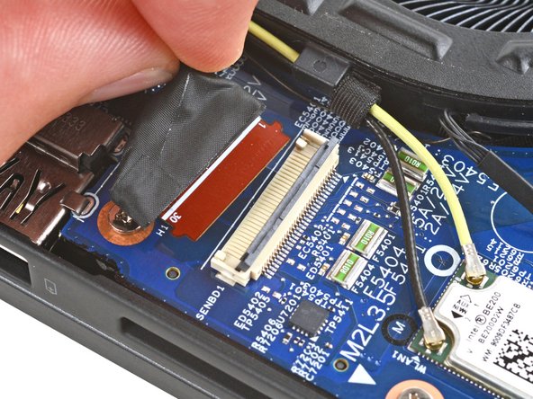

    • Use the flat end of a spudger to lift the locking flap on the screen cable ZIF connector near the left edge of your laptop.
  15. Lenovo ThinkPad P1 Gen 7 Screen Replacement: crwdns2935265:015crwdnd2935265:01crwdnd2935265:03crwdne2935265:0 Lenovo ThinkPad P1 Gen 7 Screen Replacement: crwdns2935265:015crwdnd2935265:02crwdnd2935265:03crwdne2935265:0 Lenovo ThinkPad P1 Gen 7 Screen Replacement: crwdns2935265:015crwdnd2935265:03crwdnd2935265:03crwdne2935265:0

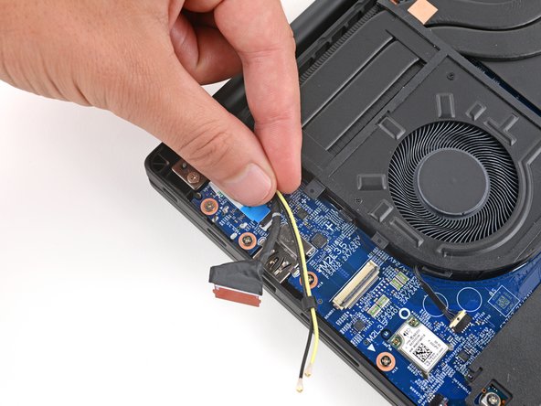

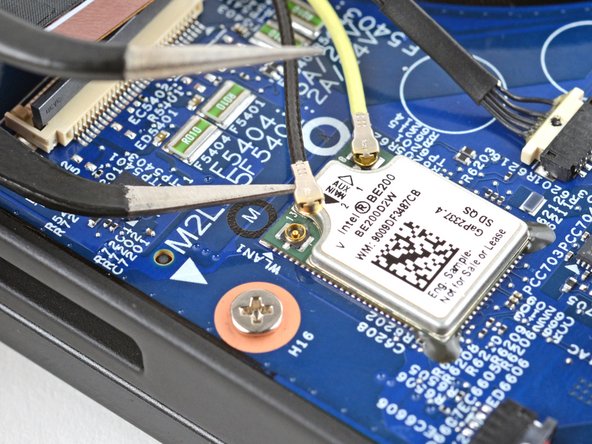

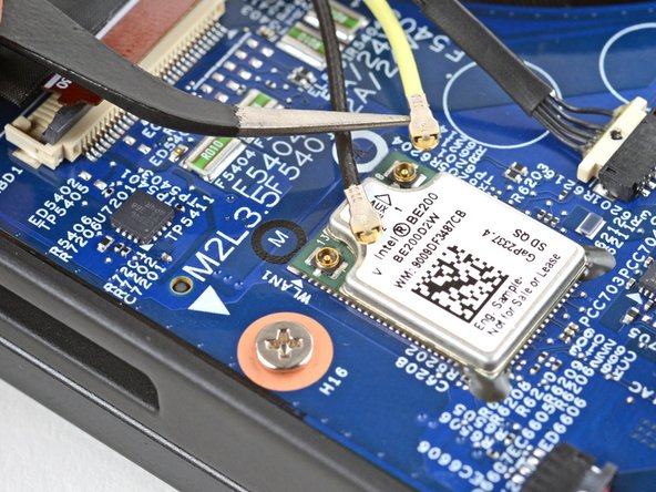

    • Slide an arm of a pair of angled tweezers under the metal neck of one of the Wi‑Fi card coaxial connectors, just below the left screen-cable.
    • Lift straight up to disconnect the cable.
    • Repeat the process to disconnect the other Wi‑Fi card cable.
  16. Lenovo ThinkPad P1 Gen 7 Screen Replacement: crwdns2935265:016crwdnd2935265:01crwdnd2935265:03crwdne2935265:0 Lenovo ThinkPad P1 Gen 7 Screen Replacement: crwdns2935265:016crwdnd2935265:02crwdnd2935265:03crwdne2935265:0 Lenovo ThinkPad P1 Gen 7 Screen Replacement: crwdns2935265:016crwdnd2935265:03crwdnd2935265:03crwdne2935265:0

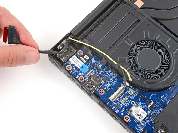

    • Use a spudger or your fingers to gently guide the two thinner cables (black and yellow) and the screen cable out of their clips on the edge of the left fan.

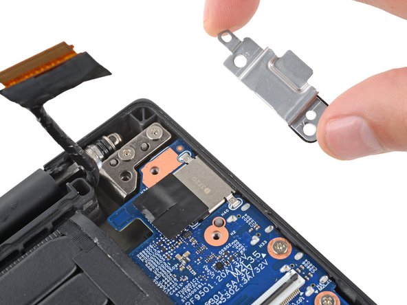

  17. Lenovo ThinkPad P1 Gen 7 Screen Replacement: crwdns2935265:017crwdnd2935265:01crwdnd2935265:01crwdne2935265:0
    • Use a Phillips screwdriver to remove the two 4.6 mm‑long screws securing the charging port bracket.
  18. Lenovo ThinkPad P1 Gen 7 Screen Replacement: crwdns2935265:018crwdnd2935265:01crwdnd2935265:02crwdne2935265:0 Lenovo ThinkPad P1 Gen 7 Screen Replacement: crwdns2935265:018crwdnd2935265:02crwdnd2935265:02crwdne2935265:0
    • Remove the charging port bracket.

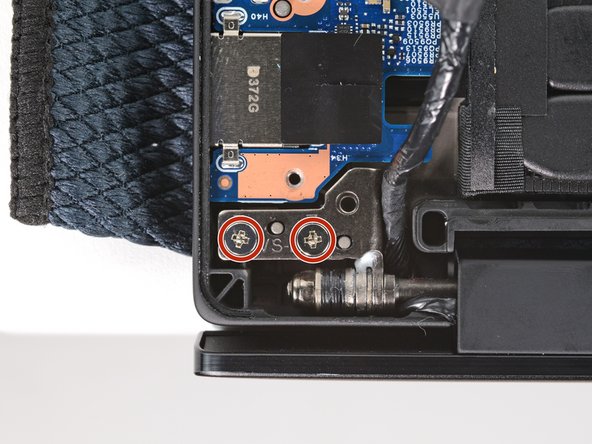

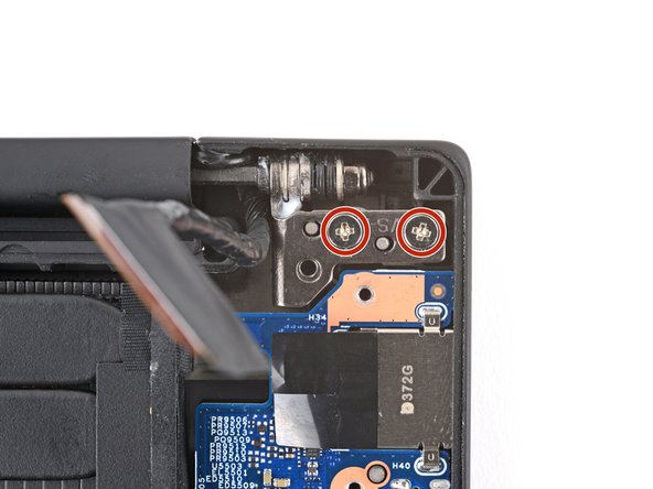

  19. Lenovo ThinkPad P1 Gen 7 Screen Replacement, Loosen the hinge screws: crwdns2935265:019crwdnd2935265:01crwdnd2935265:02crwdne2935265:0 Lenovo ThinkPad P1 Gen 7 Screen Replacement, Loosen the hinge screws: crwdns2935265:019crwdnd2935265:02crwdnd2935265:02crwdne2935265:0
    • Use a Phillips screwdriver to loosen (not remove) all four hinge screws.

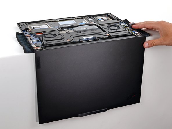

  20. Lenovo ThinkPad P1 Gen 7 Screen Replacement: crwdns2935265:020crwdnd2935265:01crwdnd2935265:02crwdne2935265:0 Lenovo ThinkPad P1 Gen 7 Screen Replacement: crwdns2935265:020crwdnd2935265:02crwdnd2935265:02crwdne2935265:0
    • Open your laptop 90 degrees and gently place it keyboard side down on a table, so the screen hangs over the edge.
    • Optionally, you can place a soft cloth under your keyboard to protect it.

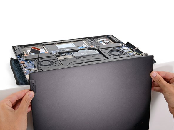

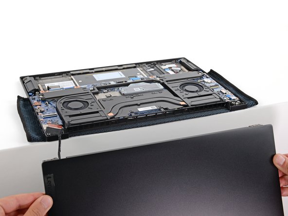

  21. Lenovo ThinkPad P1 Gen 7 Screen Replacement, Remove the screen: crwdns2935265:021crwdnd2935265:01crwdnd2935265:03crwdne2935265:0 Lenovo ThinkPad P1 Gen 7 Screen Replacement, Remove the screen: crwdns2935265:021crwdnd2935265:02crwdnd2935265:03crwdne2935265:0 Lenovo ThinkPad P1 Gen 7 Screen Replacement, Remove the screen: crwdns2935265:021crwdnd2935265:03crwdnd2935265:03crwdne2935265:0
    • Keep a firm grip on your laptop, as it can easily fall off the table.

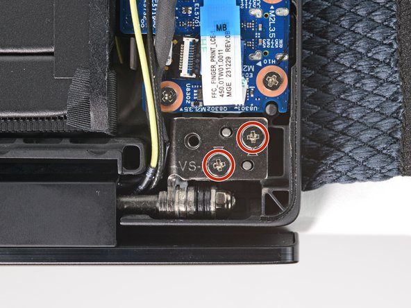

    • Support the screen with one hand and use your free hand to remove the four 4.4 mm–long Phillips screws securing the hinges.
  22. Lenovo ThinkPad P1 Gen 7 Screen Replacement: crwdns2935265:022crwdnd2935265:01crwdnd2935265:03crwdne2935265:0 Lenovo ThinkPad P1 Gen 7 Screen Replacement: crwdns2935265:022crwdnd2935265:02crwdnd2935265:03crwdne2935265:0 Lenovo ThinkPad P1 Gen 7 Screen Replacement: crwdns2935265:022crwdnd2935265:03crwdnd2935265:03crwdne2935265:0
    • Hold the screen with both hands and lift the hinges out of their recesses to remove the screen.
    • During reassembly:
    • Make sure the screen hinges are open 90 degrees and guide them into their recesses in the frame.
    • Install and partially tighten the four hinge screws.
    • Close your laptop and make sure the screen is properly aligned. If it clicks or snaps, readjust the alignment.
    • Fully tighten the hinge screws.
