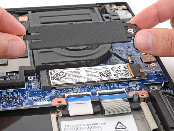

  13. Lenovo ThinkPad P1 Gen 7 SSD Replacement, Remove the SSD cover: crwdns2935265:013crwdnd2935265:01crwdnd2935265:01crwdne2935265:0
    • Use a Phillips screwdriver to loosen the two captive screws securing the SSD cover.

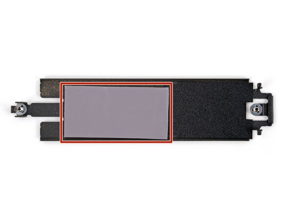

  14. Lenovo ThinkPad P1 Gen 7 SSD Replacement: crwdns2935265:014crwdnd2935265:01crwdnd2935265:03crwdne2935265:0 Lenovo ThinkPad P1 Gen 7 SSD Replacement: crwdns2935265:014crwdnd2935265:02crwdnd2935265:03crwdne2935265:0 Lenovo ThinkPad P1 Gen 7 SSD Replacement: crwdns2935265:014crwdnd2935265:03crwdnd2935265:03crwdne2935265:0
    • Lift and remove the SSD cover.
    • You may feel slight resistance, as there's a thin thermal pad between the top of the SSD and the cover.
    • During reassembly:
    • Make sure the bottom of the cover has a thermal pad. If the pad remained intact on top of the old SSD, carefully transfer it to the cover.
    • If you're replacing the pad, make sure the new one is the same thickness as the old pad.

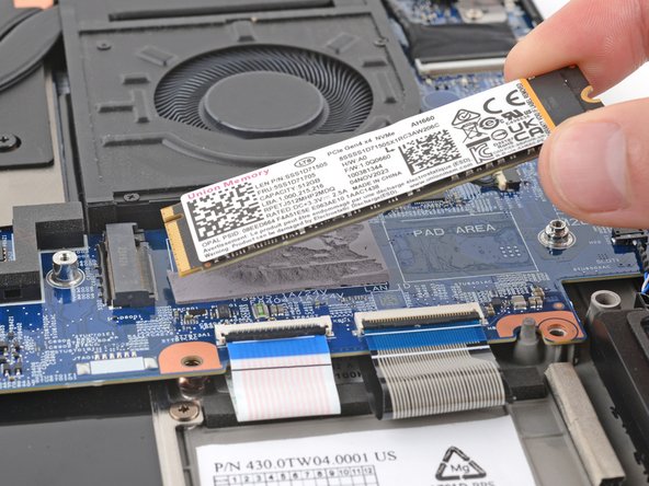

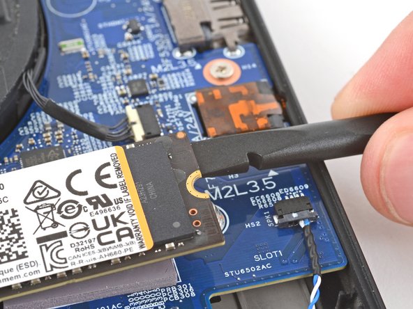

  15. Lenovo ThinkPad P1 Gen 7 SSD Replacement, Remove the SSD: crwdns2935265:015crwdnd2935265:01crwdnd2935265:03crwdne2935265:0 Lenovo ThinkPad P1 Gen 7 SSD Replacement, Remove the SSD: crwdns2935265:015crwdnd2935265:02crwdnd2935265:03crwdne2935265:0 Lenovo ThinkPad P1 Gen 7 SSD Replacement, Remove the SSD: crwdns2935265:015crwdnd2935265:03crwdnd2935265:03crwdne2935265:0
    • Two thermal pads bond the bottom of the SSD to the motherboard. Depending on their age and condition, it may take some force to separate the SSD from the pads.
    • Grip the SSD by its edges near the screw notch and lift to separate it from the thermal pads underneath—it should pop up at a slight angle.
    • Lift with gradual force. If the SSD detaches from the pads unexpectedly, you may pull up too hard and damage the socket.
    • If the SSD isn't budging, try using the flat end of a spudger to pry up the edge of the SSD with the screw notch.

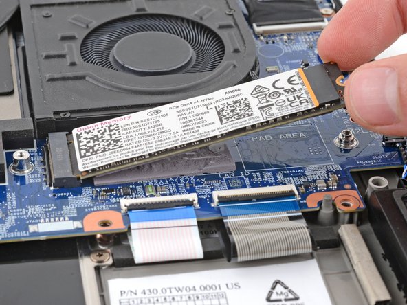

  16. Lenovo ThinkPad P1 Gen 7 SSD Replacement: crwdns2935265:016crwdnd2935265:01crwdnd2935265:02crwdne2935265:0 Lenovo ThinkPad P1 Gen 7 SSD Replacement: crwdns2935265:016crwdnd2935265:02crwdnd2935265:02crwdne2935265:0
    • Grip the SSD by its edges near the screw notch and pull it straight out of its socket.
  17. Lenovo ThinkPad P1 Gen 7 SSD Replacement, Thermal pad information: crwdns2935265:017crwdnd2935265:01crwdnd2935265:03crwdne2935265:0 Lenovo ThinkPad P1 Gen 7 SSD Replacement, Thermal pad information: crwdns2935265:017crwdnd2935265:02crwdnd2935265:03crwdne2935265:0 Lenovo ThinkPad P1 Gen 7 SSD Replacement, Thermal pad information: crwdns2935265:017crwdnd2935265:03crwdnd2935265:03crwdne2935265:0
    • Check the condition of the two thermal pads under the SSD and replace them if they're damaged. If a pad remained intact on the bottom of the old SSD, carefully transfer it to its spot on the board.
    • If you're changing the type of SSD (single-sided or double-sided), you'll need to change the pads so they're the proper thickness.
    • To replace a damaged pad:
    • Make sure your new pad is the correct thickness and size. Pad thickness depends on the type of your replacement SSD—2.25 mm for a single-sided SSD and 0.8 mm for a double-sided SSD.
    • Use a spudger or your fingers to carefully remove all of the old pad from the motherboard.
    • Be very careful not to damage any of the small surface-mounted components on the board.
    • Use highly-concentrated (more than 90%) isopropyl alcohol and a lint-free cloth (or coffee filters) to clean up any thermal pad residue.
    • Carefully put the new pad onto the board, making sure it goes into the rectangle marked PAD AREA.

Thanks, good piece. It looks like you are installing the SSD in the second slot. And the text mentions that we should check for a thermal pad in the SSD cover. Is there a thermal pad in that cover when it has not been used before? I will install a Samsung 990 Pro 1 TB drive there and I'd like to know what thermal pads to acquire for this.
