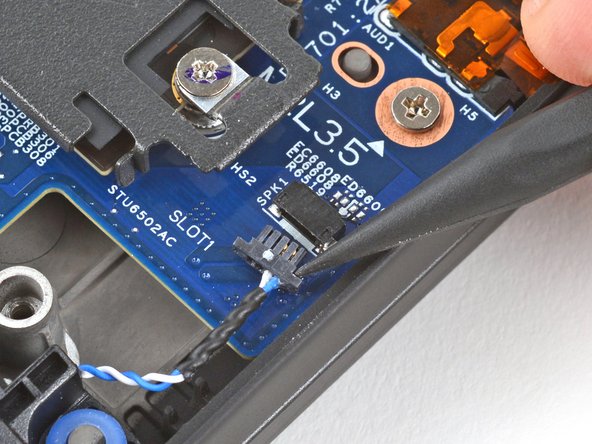

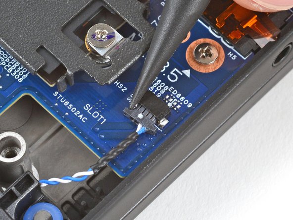

  12. Lenovo ThinkPad P1 Gen 7 Left Speaker Replacement, Remove the speaker: crwdns2935265:012crwdnd2935265:01crwdnd2935265:03crwdne2935265:0 Lenovo ThinkPad P1 Gen 7 Left Speaker Replacement, Remove the speaker: crwdns2935265:012crwdnd2935265:02crwdnd2935265:03crwdne2935265:0 Lenovo ThinkPad P1 Gen 7 Left Speaker Replacement, Remove the speaker: crwdns2935265:012crwdnd2935265:03crwdnd2935265:03crwdne2935265:0
    • The left speaker has the letters SPK-L engraved near the bottom.
    • Use the point of a spudger to push on alternating sides of the left speaker connector and "walk" it out of its socket.

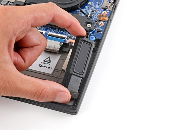

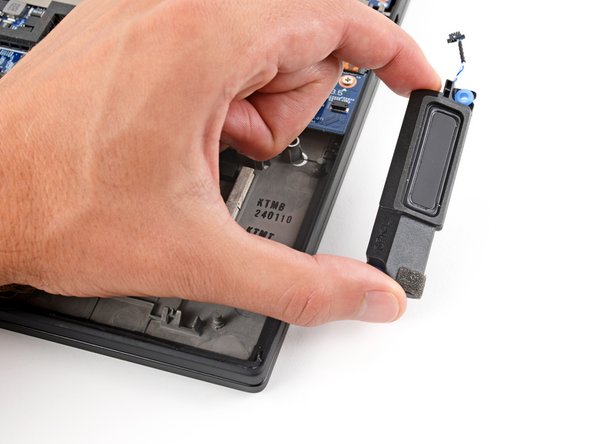

  13. Lenovo ThinkPad P1 Gen 7 Left Speaker Replacement: crwdns2935265:013crwdnd2935265:01crwdnd2935265:03crwdne2935265:0 Lenovo ThinkPad P1 Gen 7 Left Speaker Replacement: crwdns2935265:013crwdnd2935265:02crwdnd2935265:03crwdne2935265:0 Lenovo ThinkPad P1 Gen 7 Left Speaker Replacement: crwdns2935265:013crwdnd2935265:03crwdnd2935265:03crwdne2935265:0
    • Use your fingers to lift the speaker off its posts and remove it.
    • During reassembly, put the two grommets over their posts and push the speaker down so it slides into place.
    • Only press on the rigid plastic at the bottom and edges of the speaker. Pushing in the center near the soft diaphragm may damage the speaker.

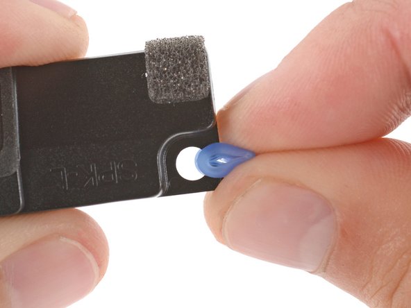

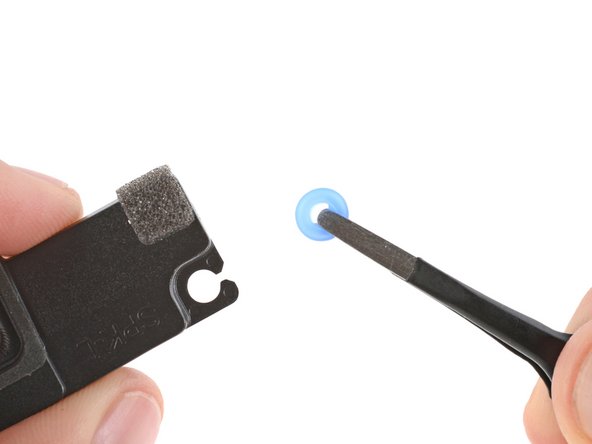

  14. Lenovo ThinkPad P1 Gen 7 Left Speaker Replacement, Transfer the grommets: crwdns2935265:014crwdnd2935265:01crwdnd2935265:03crwdne2935265:0 Lenovo ThinkPad P1 Gen 7 Left Speaker Replacement, Transfer the grommets: crwdns2935265:014crwdnd2935265:02crwdnd2935265:03crwdne2935265:0 Lenovo ThinkPad P1 Gen 7 Left Speaker Replacement, Transfer the grommets: crwdns2935265:014crwdnd2935265:03crwdnd2935265:03crwdne2935265:0
    • Make sure your replacement speaker has two rubber grommets—one in the top right-corner, and one in the bottom-left corner.
    • If it doesn't, remove the grommets from your old speaker and install them in your replacement.
    • Installing a grommet can be tricky. Use your fingers to pinch the grommet and slide it into place.
