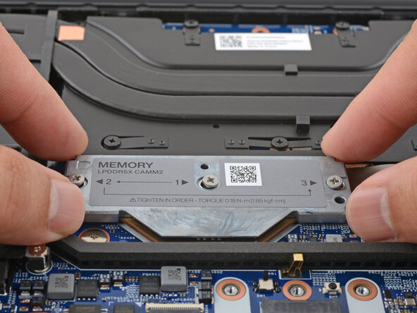

  12. Lenovo ThinkPad P1 Gen 7 LPCAMM2 Memory Replacement, Loosen the LPCAMM2 screws: crwdns2935265:012crwdnd2935265:01crwdnd2935265:01crwdne2935265:0
    • Use a Phillips screwdriver to loosen the three captive screws securing the LPCAMM2 bracket.
    • The loosening order doesn't matter.
  13. Lenovo ThinkPad P1 Gen 7 LPCAMM2 Memory Replacement, Remove the LPCAMM2 bracket: crwdns2935265:013crwdnd2935265:01crwdnd2935265:02crwdne2935265:0 Lenovo ThinkPad P1 Gen 7 LPCAMM2 Memory Replacement, Remove the LPCAMM2 bracket: crwdns2935265:013crwdnd2935265:02crwdnd2935265:02crwdne2935265:0
    • Grab the edges of the LPCAMM2 bracket and lift straight up to remove it.
    • If your LPCAMM2 module came up with the bracket, use your fingers to gently separate it from the bracket.
    • Avoid touching the gold underside of the module—your skin oils can interfere with the electrical contacts. If you touch it by accident and plan to re-use it, clean it with high-concentration isopropyl alcohol (>90%) and a lint-free cloth before reinstalling it.

  16. Lenovo ThinkPad P1 Gen 7 LPCAMM2 Memory Replacement, Reassembly: install the LPCAMM2: crwdns2935265:016crwdnd2935265:01crwdnd2935265:02crwdne2935265:0 Lenovo ThinkPad P1 Gen 7 LPCAMM2 Memory Replacement, Reassembly: install the LPCAMM2: crwdns2935265:016crwdnd2935265:02crwdnd2935265:02crwdne2935265:0
    • The remaining steps show how to reassemble the device.
    • Grip the LPCAMM2 by its edges, and lay it on top of the compression connector.
    • Make sure the LPCAMM2 aligns with the pegs.
  17. Lenovo ThinkPad P1 Gen 7 LPCAMM2 Memory Replacement, Install the bracket: crwdns2935265:017crwdnd2935265:01crwdnd2935265:02crwdne2935265:0 Lenovo ThinkPad P1 Gen 7 LPCAMM2 Memory Replacement, Install the bracket: crwdns2935265:017crwdnd2935265:02crwdnd2935265:02crwdne2935265:0
    • Lay the bracket on top of the LPCAMM2 and align it using the screw holes.
  18. Lenovo ThinkPad P1 Gen 7 LPCAMM2 Memory Replacement, Secure the LPCAMM2: crwdns2935265:018crwdnd2935265:01crwdnd2935265:03crwdne2935265:0 Lenovo ThinkPad P1 Gen 7 LPCAMM2 Memory Replacement, Secure the LPCAMM2: crwdns2935265:018crwdnd2935265:02crwdnd2935265:03crwdne2935265:0 Lenovo ThinkPad P1 Gen 7 LPCAMM2 Memory Replacement, Secure the LPCAMM2: crwdns2935265:018crwdnd2935265:03crwdnd2935265:03crwdne2935265:0
    • Tighten the three LPCAMM2 screws in the order depicted on the module.
    • In this case, tighten the screws centerleftright.
    • Tighten the screws until they're snug. Don't over-tighten them, or you could damage the module.
