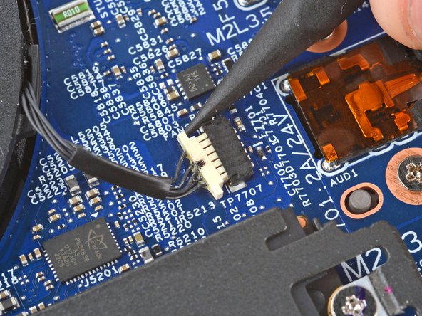

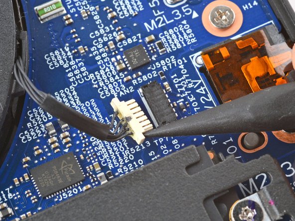

  13. Lenovo ThinkPad P1 Gen 7 Fans and Heatsink Assembly Replacement, Disconnect the assembly: crwdns2935265:013crwdnd2935265:01crwdnd2935265:03crwdne2935265:0 Lenovo ThinkPad P1 Gen 7 Fans and Heatsink Assembly Replacement, Disconnect the assembly: crwdns2935265:013crwdnd2935265:02crwdnd2935265:03crwdne2935265:0 Lenovo ThinkPad P1 Gen 7 Fans and Heatsink Assembly Replacement, Disconnect the assembly: crwdns2935265:013crwdnd2935265:03crwdnd2935265:03crwdne2935265:0
  14. Lenovo ThinkPad P1 Gen 7 Fans and Heatsink Assembly Replacement: crwdns2935265:014crwdnd2935265:01crwdnd2935265:03crwdne2935265:0 Lenovo ThinkPad P1 Gen 7 Fans and Heatsink Assembly Replacement: crwdns2935265:014crwdnd2935265:02crwdnd2935265:03crwdne2935265:0 Lenovo ThinkPad P1 Gen 7 Fans and Heatsink Assembly Replacement: crwdns2935265:014crwdnd2935265:03crwdnd2935265:03crwdne2935265:0

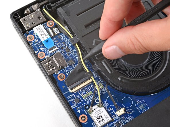

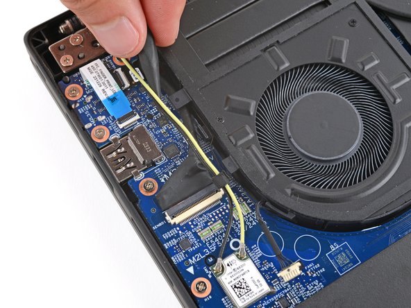

  15. Lenovo ThinkPad P1 Gen 7 Fans and Heatsink Assembly Replacement: crwdns2935265:015crwdnd2935265:01crwdnd2935265:03crwdne2935265:0 Lenovo ThinkPad P1 Gen 7 Fans and Heatsink Assembly Replacement: crwdns2935265:015crwdnd2935265:02crwdnd2935265:03crwdne2935265:0 Lenovo ThinkPad P1 Gen 7 Fans and Heatsink Assembly Replacement: crwdns2935265:015crwdnd2935265:03crwdnd2935265:03crwdne2935265:0
    • Use a spudger or your fingers to gently guide the two thinner cables (black and yellow) out of their clips on the edge of the left fan.
    • During reassembly, route the two thinner cables and the thicker screen cable into their clips.

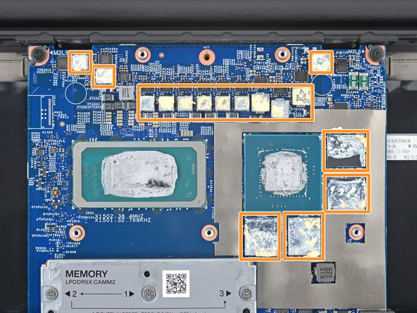

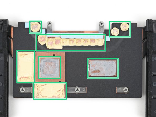

  19. Lenovo ThinkPad P1 Gen 7 Fans and Heatsink Assembly Replacement, Thermal paste application: crwdns2935265:019crwdnd2935265:01crwdnd2935265:03crwdne2935265:0 Lenovo ThinkPad P1 Gen 7 Fans and Heatsink Assembly Replacement, Thermal paste application: crwdns2935265:019crwdnd2935265:02crwdnd2935265:03crwdne2935265:0 Lenovo ThinkPad P1 Gen 7 Fans and Heatsink Assembly Replacement, Thermal paste application: crwdns2935265:019crwdnd2935265:03crwdnd2935265:03crwdne2935265:0
    • Reference our thermal paste guide for cleaning and application during the next two steps.
    • Remove all the old thermal paste and its residue from the motherboard:
    • The CPU and GPU have gray thermal paste on them.
    • Depending on the model, your laptop may only have a CPU.
    • The components around the CPU and GPU have a yellow, viscous thermal compound.
    • If you're reusing the heatsink and fan assembly, remove all the old thermal paste and compound from the corresponding spots on its underside.
    • Don't remove the small blue pads from the top edge.

  21. Lenovo ThinkPad P1 Gen 7 Fans and Heatsink Assembly Replacement: crwdns2935265:021crwdnd2935265:01crwdnd2935265:02crwdne2935265:0 Lenovo ThinkPad P1 Gen 7 Fans and Heatsink Assembly Replacement: crwdns2935265:021crwdnd2935265:02crwdnd2935265:02crwdne2935265:0
    • If you're reusing the assembly, you can skip this step.
    • If any of the small blue thermal pads stuck to the top edge of the heatsink, carefully remove and transfer them to their corresponding spots on the motherboard.
