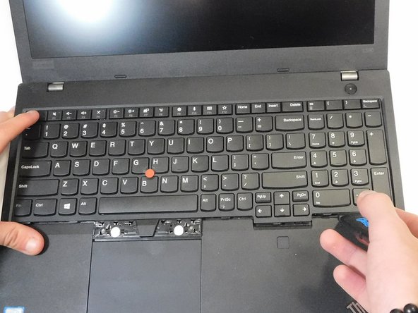

    • Shut down your ThinkPad L590 before beginning; do not put it to sleep or hibernate. Disconnect the AC adapter and any peripheral devices (USB drives, external monitors, etc.).
    • Remove the left and right click keys using an opening tool.

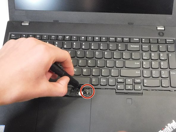

  2. Lenovo ThinkPad L590 Keyboard Replacement: crwdns2935265:02crwdnd2935265:01crwdnd2935265:02crwdne2935265:0 Lenovo ThinkPad L590 Keyboard Replacement: crwdns2935265:02crwdnd2935265:02crwdnd2935265:02crwdne2935265:0
    • Use a Phillips screwdriver to remove the two 2.5 mm screws that were hidden under the left and right click keys.

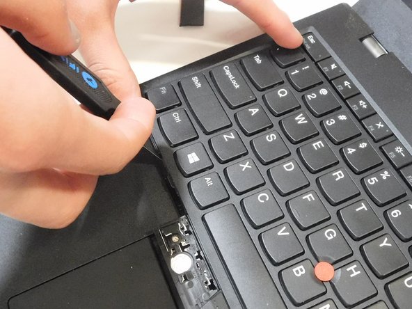

    • Insert an opening pick in the gap between the keyboard and chassis.
    • Slide the opening pick around the perimeter of the keyboard to release all of the retaining clips.
    • Be gentle to avoid breaking the clips.

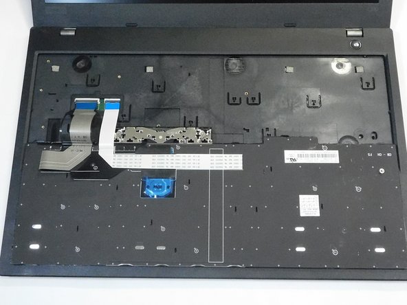

  4. Lenovo ThinkPad L590 Keyboard Replacement: crwdns2935265:04crwdnd2935265:01crwdnd2935265:02crwdne2935265:0 Lenovo ThinkPad L590 Keyboard Replacement: crwdns2935265:04crwdnd2935265:02crwdnd2935265:02crwdne2935265:0

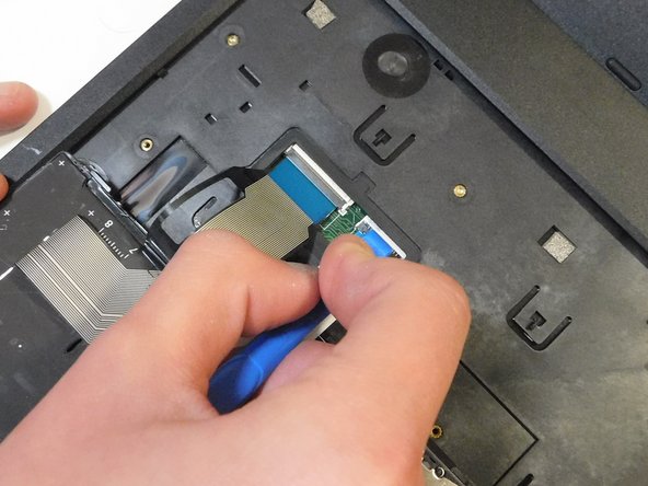

    • Gently lift the keyboard up at an angle, and tilt it back far enough to expose the ribbon cable that connects the keyboard to the motherboard.
    • Take care not to strain the ribbon cable.
  5. Lenovo ThinkPad L590 Keyboard Replacement: crwdns2935265:05crwdnd2935265:01crwdnd2935265:03crwdne2935265:0 Lenovo ThinkPad L590 Keyboard Replacement: crwdns2935265:05crwdnd2935265:02crwdnd2935265:03crwdne2935265:0 Lenovo ThinkPad L590 Keyboard Replacement: crwdns2935265:05crwdnd2935265:03crwdnd2935265:03crwdne2935265:0

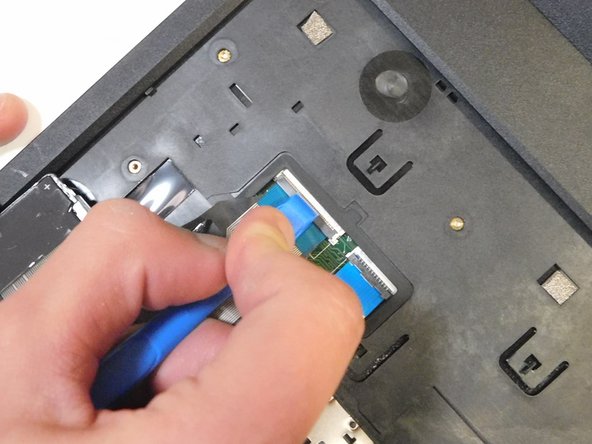

    • Use a plastic spudger to flip up both of the ZIF locking flaps. Once the latch is released, carefully pull the ribbon cable from the motherboard.
    • Disconnect both of the ribbon cables.

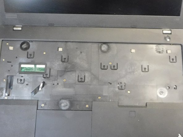

  6. Lenovo ThinkPad L590 Keyboard Replacement: crwdns2935265:06crwdnd2935265:01crwdnd2935265:02crwdne2935265:0 Lenovo ThinkPad L590 Keyboard Replacement: crwdns2935265:06crwdnd2935265:02crwdnd2935265:02crwdne2935265:0
    • Remove the keyboard assembly.
