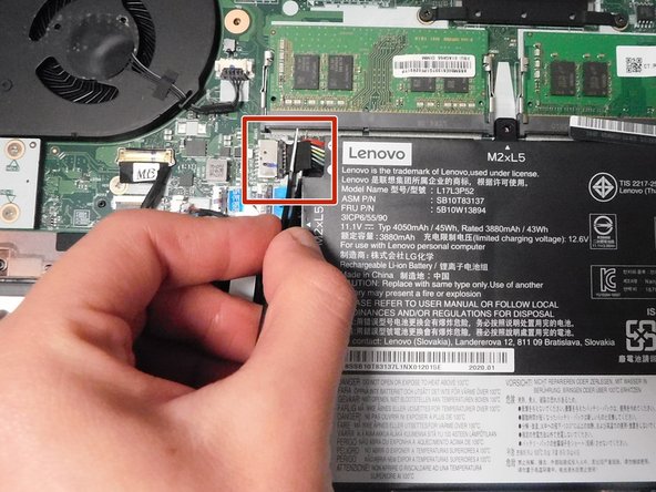

  4. Lenovo ThinkPad L590 Battery Replacement, Battery: crwdns2935265:04crwdnd2935265:01crwdnd2935265:02crwdne2935265:0 Lenovo ThinkPad L590 Battery Replacement, Battery: crwdns2935265:04crwdnd2935265:02crwdnd2935265:02crwdne2935265:0
    • Grip the battery connector with tweezers and pull it directly out of its motherboard socket.

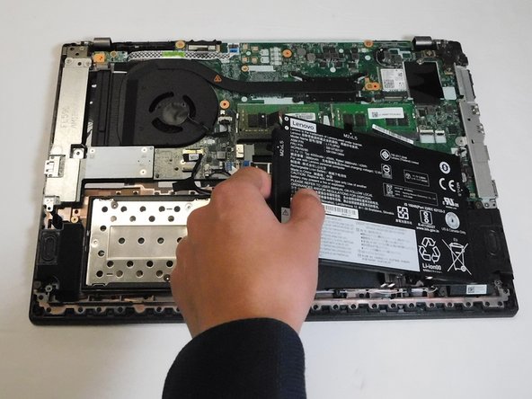

  5. Lenovo ThinkPad L590 Battery Replacement: crwdns2935265:05crwdnd2935265:01crwdnd2935265:01crwdne2935265:0
    • Use a Phillips screwdriver to remove the four screws that secure the battery:
    • Three 5.5 mm screws
    • One 3.3 mm screw
  6. Lenovo ThinkPad L590 Battery Replacement: crwdns2935265:06crwdnd2935265:01crwdnd2935265:02crwdne2935265:0 Lenovo ThinkPad L590 Battery Replacement: crwdns2935265:06crwdnd2935265:02crwdnd2935265:02crwdne2935265:0
    • Remove the battery.
For optimal performance, after completing this guide, calibrate your newly installed battery.
