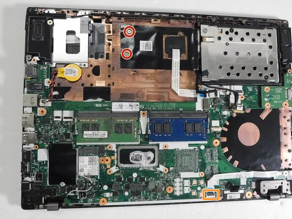

  5. Lenovo ThinkPad L490 Keyboard Replacement, Keyboard: crwdns2935265:05crwdnd2935265:01crwdnd2935265:03crwdne2935265:0 Lenovo ThinkPad L490 Keyboard Replacement, Keyboard: crwdns2935265:05crwdnd2935265:02crwdnd2935265:03crwdne2935265:0 Lenovo ThinkPad L490 Keyboard Replacement, Keyboard: crwdns2935265:05crwdnd2935265:03crwdnd2935265:03crwdne2935265:0
    • Use a Phillips screwdriver to remove the two screws that secure the keyboard.
    • Flip up the black ZIF locking flap and disconnect the ribbon cable.
  6. Lenovo ThinkPad L490 Keyboard Replacement: crwdns2935265:06crwdnd2935265:01crwdnd2935265:03crwdne2935265:0 Lenovo ThinkPad L490 Keyboard Replacement: crwdns2935265:06crwdnd2935265:02crwdnd2935265:03crwdne2935265:0 Lenovo ThinkPad L490 Keyboard Replacement: crwdns2935265:06crwdnd2935265:03crwdnd2935265:03crwdne2935265:0

This guide is dangerous because it omits that below the two mouse buttons are two screws that need to be removed.
If you don't remove them the keyboard will not move without excessive force because it is still held in place in the bottom middle by this.
Gerald Hopf - crwdns2934203:0crwdne2934203:0
Also the description which screws neet to be removed in step 5 "remove the four screws that secure the keyboard" is a total hallucination. Those screws do either not exist because they are part of the already removed back cover or they just secure the mainboard. None of those have anything to do with the keyboard! They keyboard is NOT secured by screws. Well actually it is, but the only screws the keyboard in the L490 is secured by are those under the mouse buttons which are not mentioned here!
Thanks for your suggestions, Gerald. We've addressed them and modified the guide. If you see anything else wonky—either on this guide or any other—feel free to edit the guide. iFixit is a wiki, after all!
