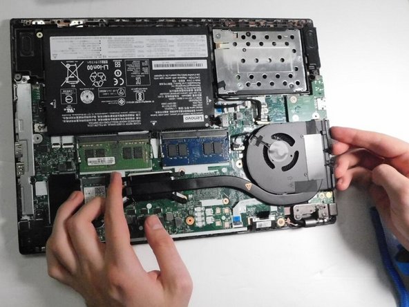

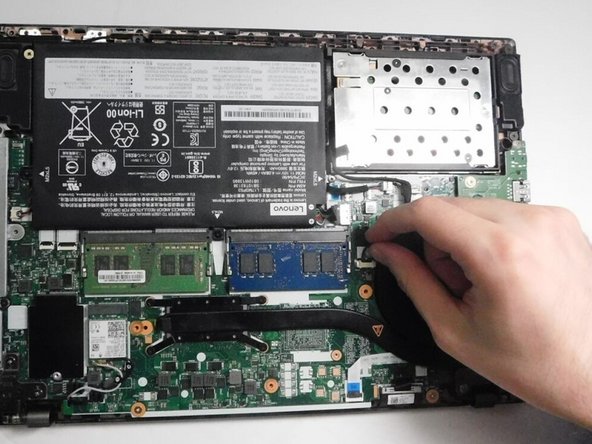

  3. Lenovo ThinkPad L490 Fan and Heatsink Replacement, Fan and Heatsink: crwdns2935265:03crwdnd2935265:01crwdnd2935265:01crwdne2935265:0
    • Grip the battery connector and pull it directly out of its motherboard socket.

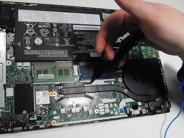

  4. Lenovo ThinkPad L490 Fan and Heatsink Replacement: crwdns2935265:04crwdnd2935265:01crwdnd2935265:03crwdne2935265:0 Lenovo ThinkPad L490 Fan and Heatsink Replacement: crwdns2935265:04crwdnd2935265:02crwdnd2935265:03crwdne2935265:0 Lenovo ThinkPad L490 Fan and Heatsink Replacement: crwdns2935265:04crwdnd2935265:03crwdnd2935265:03crwdne2935265:0
    • Use your fingernails to gently "walk" the fan connector directly out of its motherboard socket.

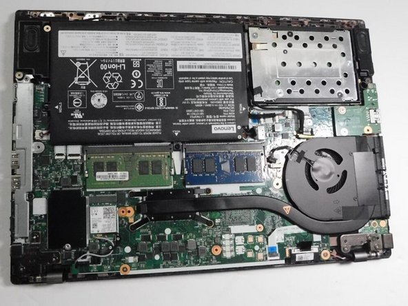

  5. Lenovo ThinkPad L490 Fan and Heatsink Replacement: crwdns2935265:05crwdnd2935265:01crwdnd2935265:02crwdne2935265:0 Lenovo ThinkPad L490 Fan and Heatsink Replacement: crwdns2935265:05crwdnd2935265:02crwdnd2935265:02crwdne2935265:0
    • Use a Phillips #00 screwdriver to remove the four M2 x 2.5 mm screws that secure the heatsink.

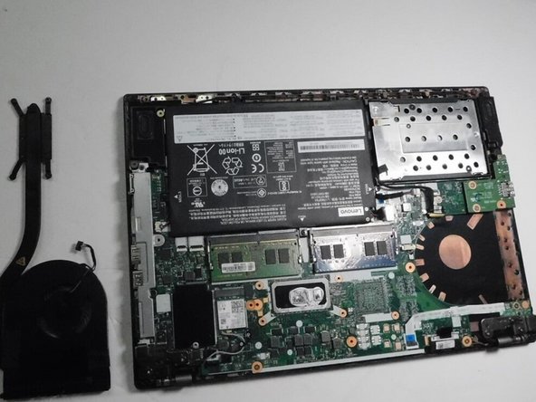

  6. Lenovo ThinkPad L490 Fan and Heatsink Replacement: crwdns2935265:06crwdnd2935265:01crwdnd2935265:03crwdne2935265:0 Lenovo ThinkPad L490 Fan and Heatsink Replacement: crwdns2935265:06crwdnd2935265:02crwdnd2935265:03crwdne2935265:0 Lenovo ThinkPad L490 Fan and Heatsink Replacement: crwdns2935265:06crwdnd2935265:03crwdnd2935265:03crwdne2935265:0
    • Gently remove the fan/heatsink assembly.
