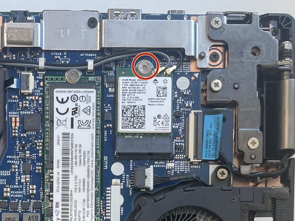

  3. Lenovo ThinkPad L390 Wi-Fi Card Replacement, Wi-Fi Card: crwdns2935265:03crwdnd2935265:01crwdnd2935265:01crwdne2935265:0
    • Remove the single 5 mm Phillips screw that secures the Wi-Fi card.

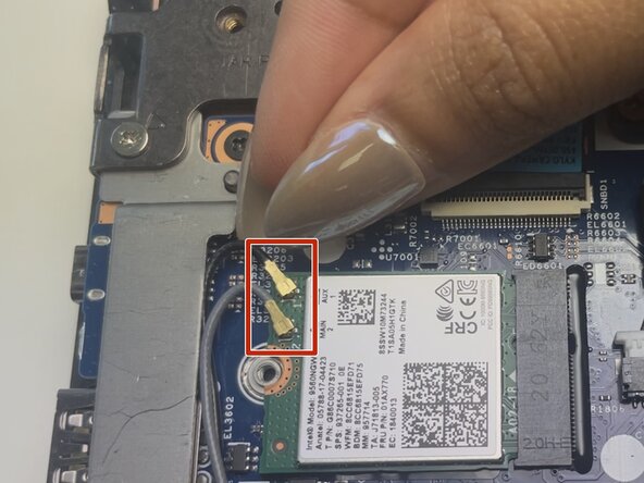

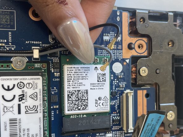

  4. Lenovo ThinkPad L390 Wi-Fi Card Replacement: crwdns2935265:04crwdnd2935265:01crwdnd2935265:02crwdne2935265:0 Lenovo ThinkPad L390 Wi-Fi Card Replacement: crwdns2935265:04crwdnd2935265:02crwdnd2935265:02crwdne2935265:0
    • Use the pointed end of a spudger to lift and disconnect the two Wi-Fi card coaxial cables.

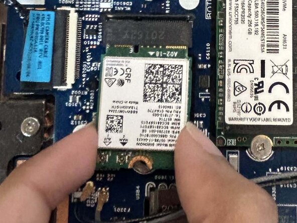

  5. Lenovo ThinkPad L390 Wi-Fi Card Replacement: crwdns2935265:05crwdnd2935265:01crwdnd2935265:01crwdne2935265:0
    • Gently pull the Wi-Fi card directly out of its socket.
