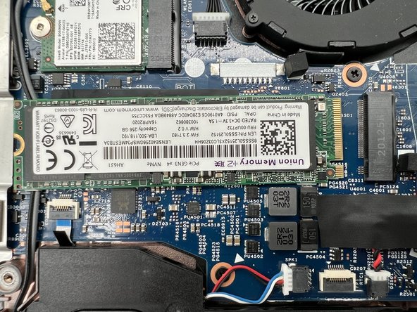

  4. Lenovo ThinkPad L390 SSD Replacement, SSD: crwdns2935265:04crwdnd2935265:01crwdnd2935265:02crwdne2935265:0 Lenovo ThinkPad L390 SSD Replacement, SSD: crwdns2935265:04crwdnd2935265:02crwdnd2935265:02crwdne2935265:0
    • Remove the 3 mm screw from that secures the SSD with a Phillips #1 screwdriver.
  5. Lenovo ThinkPad L390 SSD Replacement: crwdns2935265:05crwdnd2935265:01crwdnd2935265:02crwdne2935265:0 Lenovo ThinkPad L390 SSD Replacement: crwdns2935265:05crwdnd2935265:02crwdnd2935265:02crwdne2935265:0
    • Use a screwdriver to pop the SSD slightly off the motherboard.
    • Parts like the SSD card are fragile so make sure to take care when handling them.
  6. Lenovo ThinkPad L390 SSD Replacement: crwdns2935265:06crwdnd2935265:01crwdnd2935265:03crwdne2935265:0 Lenovo ThinkPad L390 SSD Replacement: crwdns2935265:06crwdnd2935265:02crwdnd2935265:03crwdne2935265:0 Lenovo ThinkPad L390 SSD Replacement: crwdns2935265:06crwdnd2935265:03crwdnd2935265:03crwdne2935265:0
    • Pinch and pull the SSD card to remove it from its connecting port on the motherboard.
