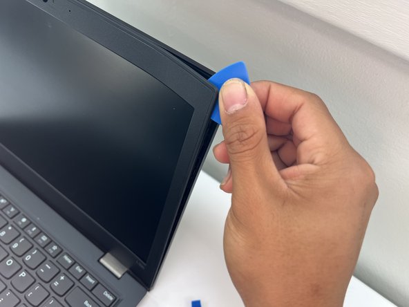

    • Open up the laptop lid.
    • Insert an opening pick under the bezel.
    • Slide the opening pick around the perimeter of the bezel until it fully releases.
    • Remove the bezel.

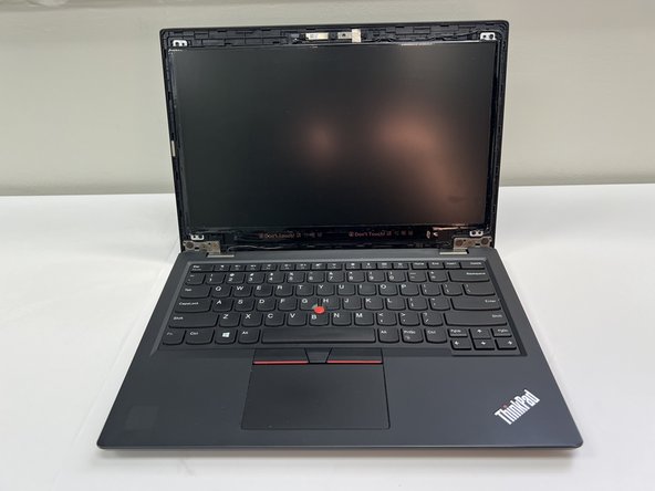

  2. Lenovo ThinkPad L390 LCD Screen Replacement: crwdns2935265:02crwdnd2935265:01crwdnd2935265:01crwdne2935265:0
    • Remove the four 3 mm screws that secure the screen with a Phillips #00 screwdriver.
    • Slightly lift the screen and set it face down on top of the keyboard.
    • Take care not to strain the connected cable.

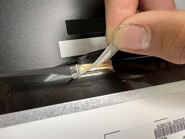

  3. Lenovo ThinkPad L390 LCD Screen Replacement: crwdns2935265:03crwdnd2935265:01crwdnd2935265:03crwdne2935265:0 Lenovo ThinkPad L390 LCD Screen Replacement: crwdns2935265:03crwdnd2935265:02crwdnd2935265:03crwdne2935265:0 Lenovo ThinkPad L390 LCD Screen Replacement: crwdns2935265:03crwdnd2935265:03crwdnd2935265:03crwdne2935265:0
    • Peel back the clear piece of tape on top of the display cable connector.

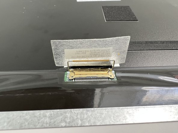

  4. Lenovo ThinkPad L390 LCD Screen Replacement: crwdns2935265:04crwdnd2935265:01crwdnd2935265:02crwdne2935265:0 Lenovo ThinkPad L390 LCD Screen Replacement: crwdns2935265:04crwdnd2935265:02crwdnd2935265:02crwdne2935265:0
    • Flip up the display cable locking bar.

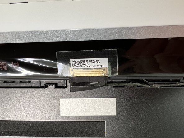

  5. Lenovo ThinkPad L390 LCD Screen Replacement: crwdns2935265:05crwdnd2935265:01crwdnd2935265:01crwdne2935265:0
    • When the bar is clear of the connector and the screen, gently disconnect the display cable connector.
    • Remove the screen.
