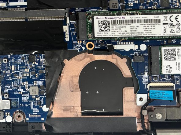

  4. Lenovo ThinkPad L390 Fan and Heat Sink Replacement, Fan and Heat Sink: crwdns2935265:04crwdnd2935265:01crwdnd2935265:01crwdne2935265:0
    • Remove the four 4 mm Phillips #00 screws that secure the heat sink.
    • Remove the 6 mm Phillips #00 screw that secures the fan.
    • Do not begin to remove the fan just yet.
  5. Lenovo ThinkPad L390 Fan and Heat Sink Replacement: crwdns2935265:05crwdnd2935265:01crwdnd2935265:02crwdne2935265:0 Lenovo ThinkPad L390 Fan and Heat Sink Replacement: crwdns2935265:05crwdnd2935265:02crwdnd2935265:02crwdne2935265:0
    • Grip the fan/heat sink assembly from both sides and lift it up and out of the chassis.
