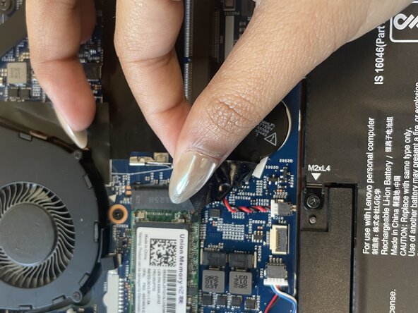

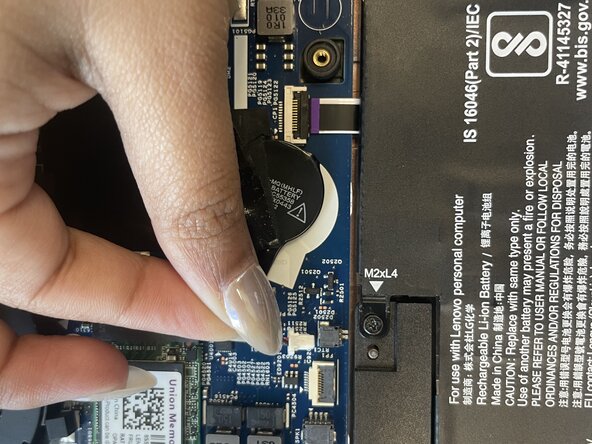

  3. Lenovo ThinkPad L390 CMOS Battery Replacement, CMOS Battery: crwdns2935265:03crwdnd2935265:01crwdnd2935265:01crwdne2935265:0
    • Remove the protective tape over the CMOS battery.
  4. Lenovo ThinkPad L390 CMOS Battery Replacement: crwdns2935265:04crwdnd2935265:01crwdnd2935265:01crwdne2935265:0
    • Pull the white CMOS battery connector directly out of its socket.
    • Lift the battery up and off of the motherboard.
