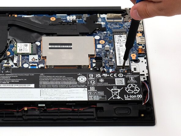

  6. Lenovo ThinkPad E15 Gen 3 SSD Replacement, SSD: crwdns2935265:06crwdnd2935265:01crwdnd2935265:02crwdne2935265:0 Lenovo ThinkPad E15 Gen 3 SSD Replacement, SSD: crwdns2935265:06crwdnd2935265:02crwdnd2935265:02crwdne2935265:0
    • Remove the 2.5 mm PH1 screw holding the SSD in place.
  7. Lenovo ThinkPad E15 Gen 3 SSD Replacement: crwdns2935265:07crwdnd2935265:01crwdnd2935265:02crwdne2935265:0 Lenovo ThinkPad E15 Gen 3 SSD Replacement: crwdns2935265:07crwdnd2935265:02crwdnd2935265:02crwdne2935265:0
    • Slide the SSD out from the socket and remove it.
    • Make sure the flat side of the SSD is laying down against the motherboard when reinstalling.
