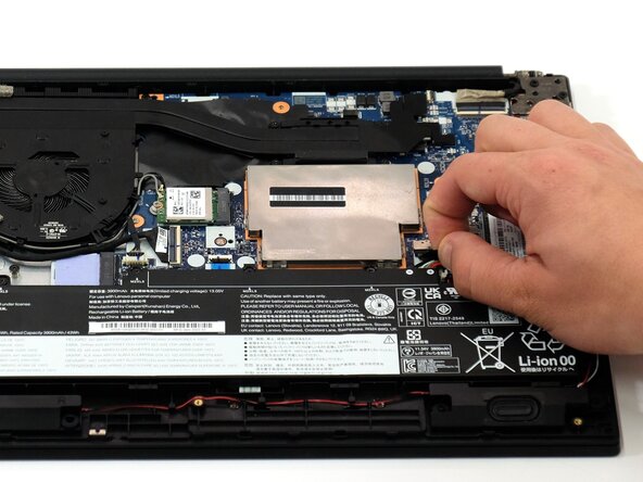

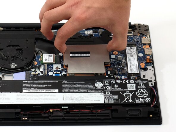

  6. Lenovo ThinkPad E15 Gen 3 RAM Replacement, RAM: crwdns2935265:06crwdnd2935265:01crwdnd2935265:03crwdne2935265:0 Lenovo ThinkPad E15 Gen 3 RAM Replacement, RAM: crwdns2935265:06crwdnd2935265:02crwdnd2935265:03crwdne2935265:0 Lenovo ThinkPad E15 Gen 3 RAM Replacement, RAM: crwdns2935265:06crwdnd2935265:03crwdnd2935265:03crwdne2935265:0
    • Gently pull on the stainless steel shielding cover to remove it from the laptop to expose the RAM.

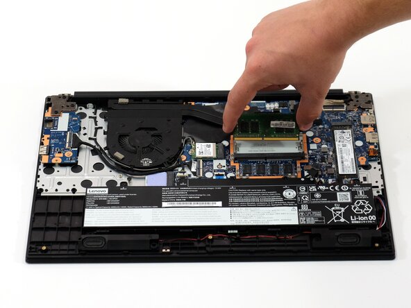

  7. Lenovo ThinkPad E15 Gen 3 RAM Replacement: crwdns2935265:07crwdnd2935265:01crwdnd2935265:02crwdne2935265:0 Lenovo ThinkPad E15 Gen 3 RAM Replacement: crwdns2935265:07crwdnd2935265:02crwdnd2935265:02crwdne2935265:0
    • Using your fingers, pull the metal arms (located on both sides of the RAM stick) slightly away from it.
    • The RAM will pop up from the motherboard once the tabs are spread apart.

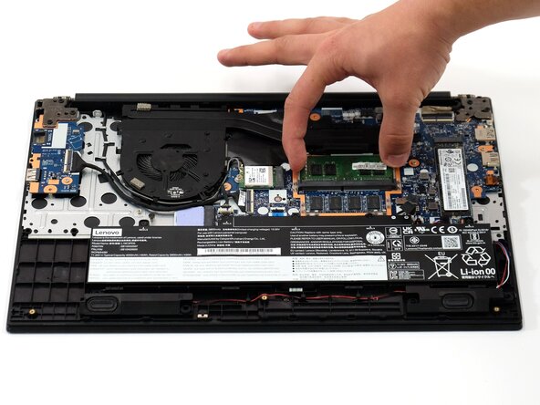

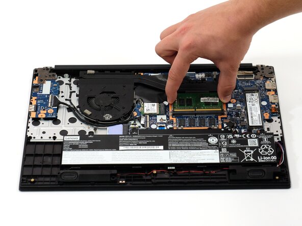

  8. Lenovo ThinkPad E15 Gen 3 RAM Replacement: crwdns2935265:08crwdnd2935265:01crwdnd2935265:03crwdne2935265:0 Lenovo ThinkPad E15 Gen 3 RAM Replacement: crwdns2935265:08crwdnd2935265:02crwdnd2935265:03crwdne2935265:0 Lenovo ThinkPad E15 Gen 3 RAM Replacement: crwdns2935265:08crwdnd2935265:03crwdnd2935265:03crwdne2935265:0
    • Slide the RAM stick from the socket to remove it from the laptop.
    • Remove it at an angle and not straight up so you don't damage the socket.
    • When installing new RAM make sure that the notch on the stick is aligned with the RAM slot on the motherboard. If the RAM's notch doesn't align with the slot, ensure that you are installing RAM that is compatible with the laptop.
