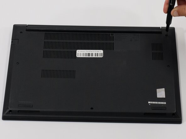

    • Loosen the eight PH1 screws on the back panel using the Phillips #1 screwdriver.
    • These screws stay seated within the back panel so do not try to remove them.

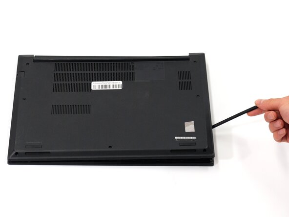

    • Remove back panel using a plastic opening tool or a spudger.
    • Ensure that all sides of the panel are separated (audible clicks will be heard when separating) from the device frame.

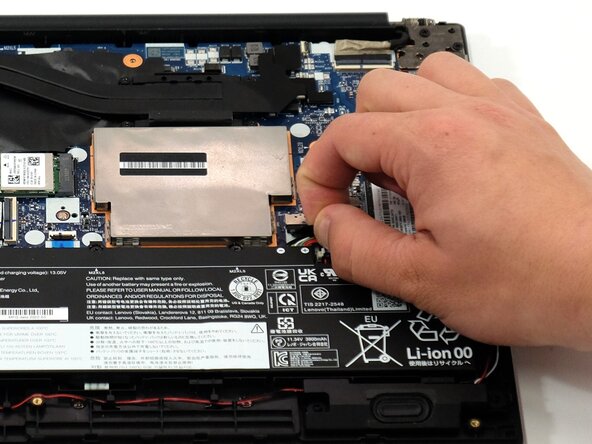

    • Gently disconnect the battery from the motherboard by pulling on the fabric tab attached to the connector.

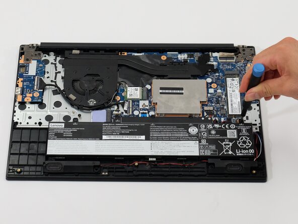

    • Use a Phillips #1 screwdriver to remove the five 5 mm screws holding the battery.

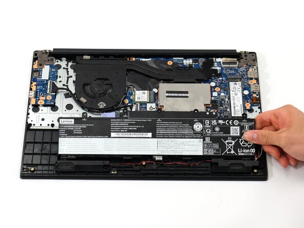

    • Remove the battery by gently lifting the top of the battery out from the frame and then pull towards the motherboard.
To reassemble your device, follow these instructions in reverse order using the new battery. For optimal performance, calibrate your newly installed battery after completing this guide.
