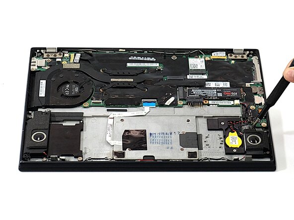

  3. Lenovo ThinkPad A285 Speakers Replacement, Speakers: crwdns2935265:03crwdnd2935265:01crwdnd2935265:02crwdne2935265:0 Lenovo ThinkPad A285 Speakers Replacement, Speakers: crwdns2935265:03crwdnd2935265:02crwdnd2935265:02crwdne2935265:0
    • Remove two 5 mm screws from each speaker using a Phillips #0 screwdriver.

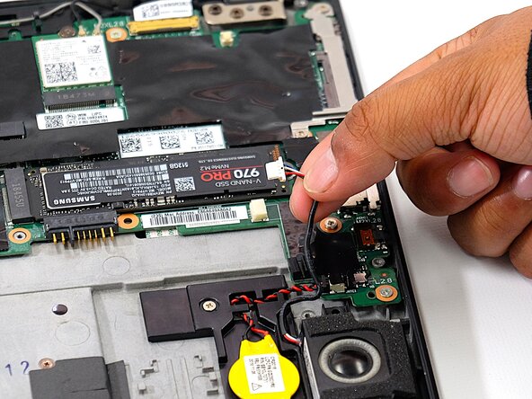

  4. Lenovo ThinkPad A285 Speakers Replacement: crwdns2935265:04crwdnd2935265:01crwdnd2935265:02crwdne2935265:0 Lenovo ThinkPad A285 Speakers Replacement: crwdns2935265:04crwdnd2935265:02crwdnd2935265:02crwdne2935265:0
    • Use the point of a spudger to push on alternating sides of the sliding speaker connector to "walk" it out of its socket.
    • It may take a lot of alternating before the connector comes out. Be patient, and don't pull on the cables.
    • To reconnect the cable, align the connector and use a spudger or clean fingernail to push it fully into the socket.

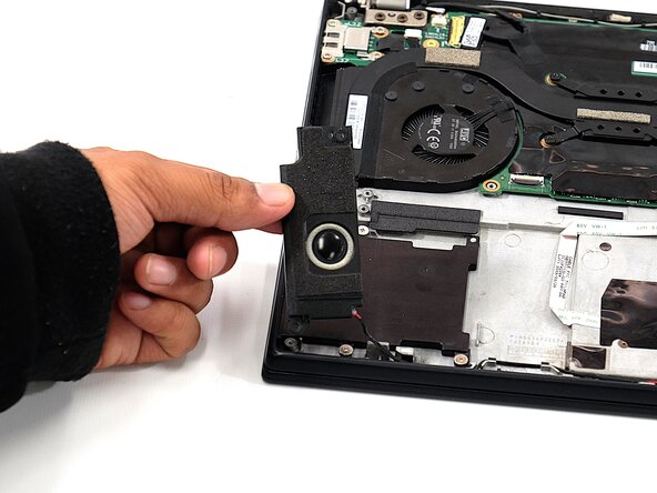

  5. Lenovo ThinkPad A285 Speakers Replacement: crwdns2935265:05crwdnd2935265:01crwdnd2935265:02crwdne2935265:0 Lenovo ThinkPad A285 Speakers Replacement: crwdns2935265:05crwdnd2935265:02crwdnd2935265:02crwdne2935265:0
    • Remove the left and right speakers by gently lifting up from the computer.
    • Before removing the speakers completely, disconnect the speaker wires from the wire routing along the edge of the chassis.
    • Be careful and avoid pulling the wires that connect the two speakers.
