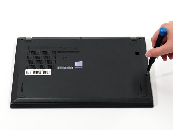

    • Flip your laptop over so the bottom panel is facing up.
    • Use a Phillips #0 to loosen the 5 screws holding the back panel to the laptop.
    • These screws do not come all the way out, so loosen until free spinning.
    • Lift the bottom of the panel to separate the back panel away from the device.
    • Remove the back panel.

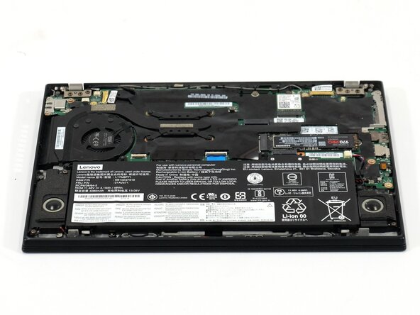

    • Use a Phillips #0 screwdriver to remove the four 5 mm screws connecting the battery to the device.
    • Slide the battery away from the connector on the motherboard to remove it.
    • When replacing the battery, make sure to slide the fins on either side of the bottom edge of the battery into the their respective slots.
To reassemble your device, follow these instructions in reverse order. For optimal performance, calibrate your newly installed battery after completing this guide.
