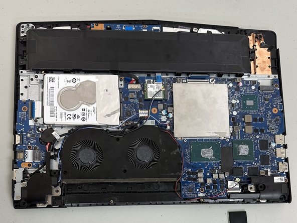

  3. Lenovo Legion Y520-15IKBN Heatsink Replacement, Fan: crwdns2935265:03crwdnd2935265:01crwdnd2935265:03crwdne2935265:0 Lenovo Legion Y520-15IKBN Heatsink Replacement, Fan: crwdns2935265:03crwdnd2935265:02crwdnd2935265:03crwdne2935265:0 Lenovo Legion Y520-15IKBN Heatsink Replacement, Fan: crwdns2935265:03crwdnd2935265:03crwdnd2935265:03crwdne2935265:0
    • There is a piece of plastic covering part of the RAM and the fan. You will need to remove this to get to the fan.
    • Unplug the battery then, you will need to remove the four 4 mm screws around the fan using a Phillips #00 screwdriver.
  4. Lenovo Legion Y520-15IKBN Heatsink Replacement: crwdns2935265:04crwdnd2935265:01crwdnd2935265:03crwdne2935265:0 Lenovo Legion Y520-15IKBN Heatsink Replacement: crwdns2935265:04crwdnd2935265:02crwdnd2935265:03crwdne2935265:0 Lenovo Legion Y520-15IKBN Heatsink Replacement: crwdns2935265:04crwdnd2935265:03crwdnd2935265:03crwdne2935265:0
    • Unscrew all the screws then unplug the wires connected to the fan.
    • Once all the wires are unplugged from the fan, move the wires aside to get the fan.
  5. Lenovo Legion Y520-15IKBN Heatsink Replacement: crwdns2935265:05crwdnd2935265:01crwdnd2935265:03crwdne2935265:0 Lenovo Legion Y520-15IKBN Heatsink Replacement: crwdns2935265:05crwdnd2935265:02crwdnd2935265:03crwdne2935265:0 Lenovo Legion Y520-15IKBN Heatsink Replacement: crwdns2935265:05crwdnd2935265:03crwdnd2935265:03crwdne2935265:0
    • Lift the fan out of the laptop body.

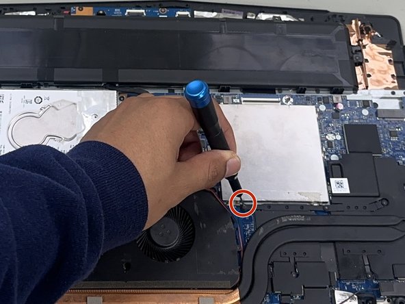

  6. Lenovo Legion Y520-15IKBN Heatsink Replacement, Heatsink: crwdns2935265:06crwdnd2935265:01crwdnd2935265:02crwdne2935265:0 Lenovo Legion Y520-15IKBN Heatsink Replacement, Heatsink: crwdns2935265:06crwdnd2935265:02crwdnd2935265:02crwdne2935265:0
    • Use a Phillips #00 screwdriver to remove the five 6.5 mm screws securing the heat sink.
  7. Lenovo Legion Y520-15IKBN Heatsink Replacement: crwdns2935265:07crwdnd2935265:01crwdnd2935265:02crwdne2935265:0 Lenovo Legion Y520-15IKBN Heatsink Replacement: crwdns2935265:07crwdnd2935265:02crwdnd2935265:02crwdne2935265:0
    • Use a spudger to gently pry the heatsink from the board.
