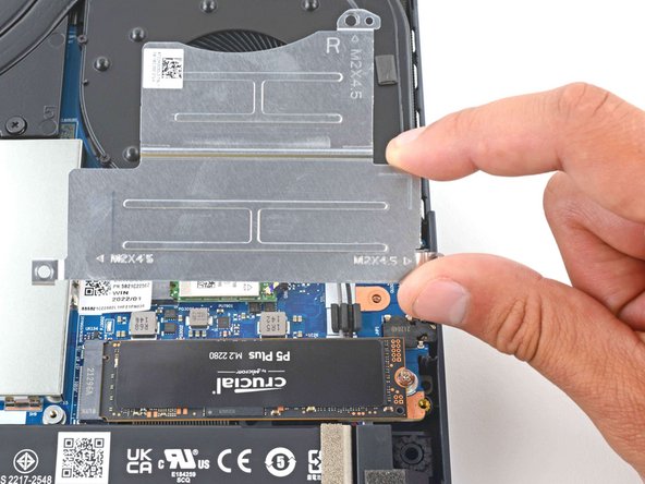

  13. Lenovo Legion 5 15ACH6H Battery Replacement, Right SSD removal: crwdns2935265:013crwdnd2935265:01crwdnd2935265:02crwdne2935265:0 Lenovo Legion 5 15ACH6H Battery Replacement, Right SSD removal: crwdns2935265:013crwdnd2935265:02crwdnd2935265:02crwdne2935265:0
    • Use a Phillips screwdriver to remove the three 5.1 mm PH00 screws securing the right SSD shield to the motherboard.
    • During reassembly, make sure the hole on the top of the shield aligns with the post on the chassis.
  14. Lenovo Legion 5 15ACH6H Battery Replacement, Remove the SSD shield: crwdns2935265:014crwdnd2935265:01crwdnd2935265:03crwdne2935265:0 Lenovo Legion 5 15ACH6H Battery Replacement, Remove the SSD shield: crwdns2935265:014crwdnd2935265:02crwdnd2935265:03crwdne2935265:0 Lenovo Legion 5 15ACH6H Battery Replacement, Remove the SSD shield: crwdns2935265:014crwdnd2935265:03crwdnd2935265:03crwdne2935265:0
    • Grab the SSD shield and lift up to remove it.
