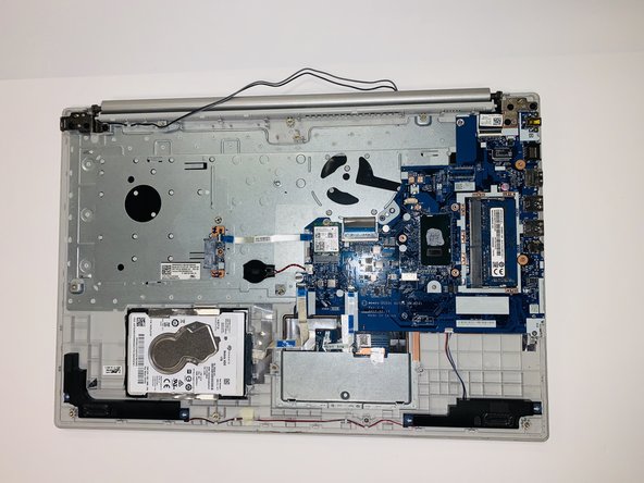

  9. Lenovo Ideapad 320-17IKB Wi-Fi Card Replacement, Heat Sink: crwdns2935265:09crwdnd2935265:01crwdnd2935265:03crwdne2935265:0 Lenovo Ideapad 320-17IKB Wi-Fi Card Replacement, Heat Sink: crwdns2935265:09crwdnd2935265:02crwdnd2935265:03crwdne2935265:0 Lenovo Ideapad 320-17IKB Wi-Fi Card Replacement, Heat Sink: crwdns2935265:09crwdnd2935265:03crwdnd2935265:03crwdne2935265:0
    • Gently lift and remove the heat sink and set it aside.

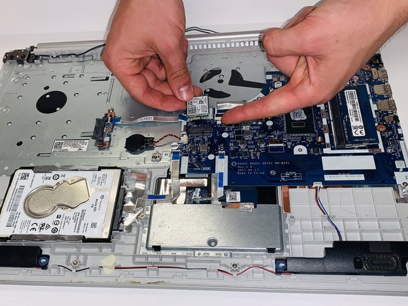

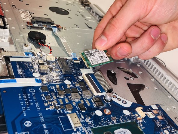

  10. Lenovo Ideapad 320-17IKB Wi-Fi Card Replacement, Wi-Fi Card: crwdns2935265:010crwdnd2935265:01crwdnd2935265:03crwdne2935265:0 Lenovo Ideapad 320-17IKB Wi-Fi Card Replacement, Wi-Fi Card: crwdns2935265:010crwdnd2935265:02crwdnd2935265:03crwdne2935265:0 Lenovo Ideapad 320-17IKB Wi-Fi Card Replacement, Wi-Fi Card: crwdns2935265:010crwdnd2935265:03crwdnd2935265:03crwdne2935265:0
    • Remove the single 3mm Phillips #0 screw from the Wi-Fi card.
    • Pull the Wi-Fi card straight out of the laptop.
