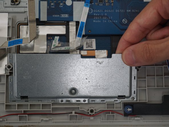

  13. Lenovo Ideapad 320-17IKB Touchpad Replacement, Touchpad: crwdns2935265:013crwdnd2935265:01crwdnd2935265:02crwdne2935265:0 Lenovo Ideapad 320-17IKB Touchpad Replacement, Touchpad: crwdns2935265:013crwdnd2935265:02crwdnd2935265:02crwdne2935265:0
    • Use a Jimmy or opening tool to pry and and release the clips that secure the touchpad cover.
    • Soldering/glue is required to reattach this part.
    • Remove the touchpad cover.

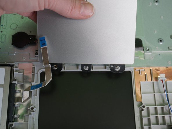

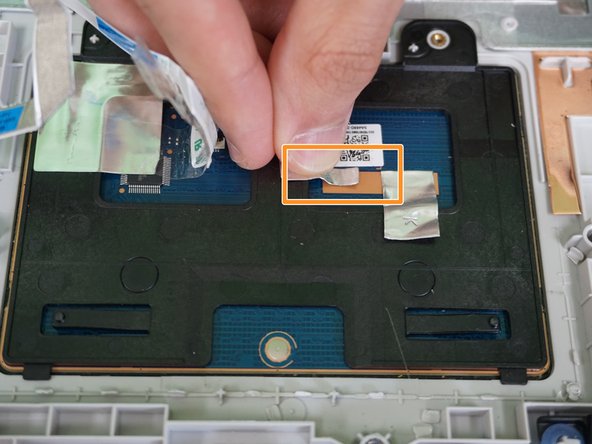

  14. Lenovo Ideapad 320-17IKB Touchpad Replacement: crwdns2935265:014crwdnd2935265:01crwdnd2935265:02crwdne2935265:0 Lenovo Ideapad 320-17IKB Touchpad Replacement: crwdns2935265:014crwdnd2935265:02crwdnd2935265:02crwdne2935265:0
    • Use a Phillips #0 screwdriver to remove two 2.42 mm screws from the top of the touchpad.

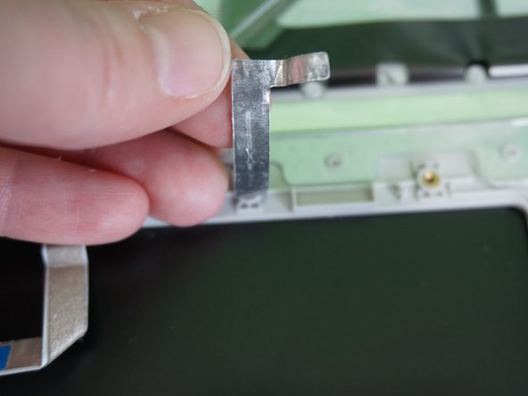

    • Peel off the ribbon cable from the touchpad, which is attached with adhesive.
  15. Lenovo Ideapad 320-17IKB Touchpad Replacement: crwdns2935265:015crwdnd2935265:01crwdnd2935265:03crwdne2935265:0 Lenovo Ideapad 320-17IKB Touchpad Replacement: crwdns2935265:015crwdnd2935265:02crwdnd2935265:03crwdne2935265:0 Lenovo Ideapad 320-17IKB Touchpad Replacement: crwdns2935265:015crwdnd2935265:03crwdnd2935265:03crwdne2935265:0
    • Lift the touchpad from the bottom to remove it.
    • When you've replaced your touchpad, remember to reattach the ribbon cable as it will not function without it.
