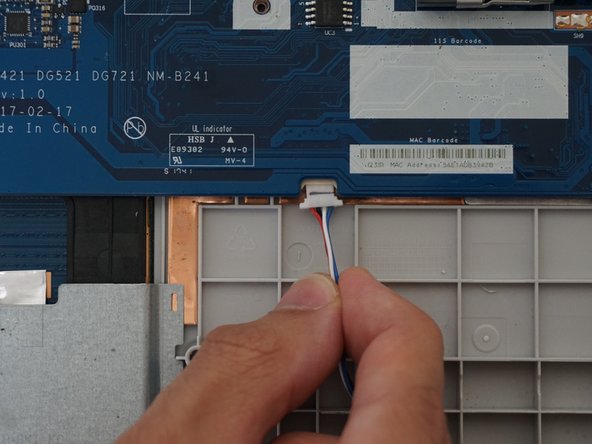

  7. Lenovo Ideapad 320-17IKB Speakers Replacement, Speakers: crwdns2935265:07crwdnd2935265:01crwdnd2935265:02crwdne2935265:0 Lenovo Ideapad 320-17IKB Speakers Replacement, Speakers: crwdns2935265:07crwdnd2935265:02crwdnd2935265:02crwdne2935265:0
    • Gently pinch the white tab and pull the speaker cable out of its socket.
    • Don't pull on the cables.
    • The speaker connector is located directly underneath the battery.
    • If you can't get the speaker cable out by hand, use the point of a spudger to push on alternating sides of the connector to "walk" it out of its socket.
    • It may take a lot of alternating before the connector comes out.
    • To reconnect the cable, align the connector and use a spudger or clean fingernail to push it fully into the socket.
    • Don't push on the cables themselves, or you may damage the connector.

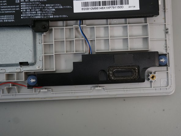

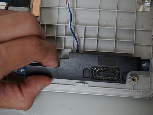

  8. Lenovo Ideapad 320-17IKB Speakers Replacement: crwdns2935265:08crwdnd2935265:01crwdnd2935265:03crwdne2935265:0 Lenovo Ideapad 320-17IKB Speakers Replacement: crwdns2935265:08crwdnd2935265:02crwdnd2935265:03crwdne2935265:0 Lenovo Ideapad 320-17IKB Speakers Replacement: crwdns2935265:08crwdnd2935265:03crwdnd2935265:03crwdne2935265:0
    • Lift the left and right speakers up and disconnect the cables from the chassis to remove the speaker assembly from the laptop.
