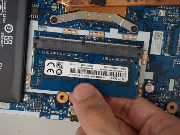

  5. Lenovo Ideapad 320-17IKB RAM Replacement, RAM: crwdns2935265:05crwdnd2935265:01crwdnd2935265:01crwdne2935265:0
    • The RAM is located on the right side of the motherboard above the battery.
  6. Lenovo Ideapad 320-17IKB RAM Replacement: crwdns2935265:06crwdnd2935265:01crwdnd2935265:02crwdne2935265:0 Lenovo Ideapad 320-17IKB RAM Replacement: crwdns2935265:06crwdnd2935265:02crwdnd2935265:02crwdne2935265:0
    • Using your fingers, pull the metal arms (located on both sides of the RAM stick) slightly away from it to release the RAM stick.
    • The RAM stick will pop up by a few millimeters.
    • Remove it at an angle and not straight up so you don't damage the socket.
    • Slide the RAM stick out from the memory module slot.
    • When installing new RAM, slide it into the port at the same angle it was removed and press down until it clicks into place.
