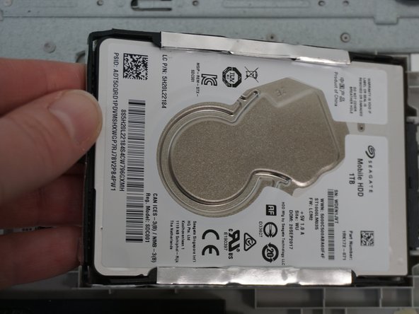

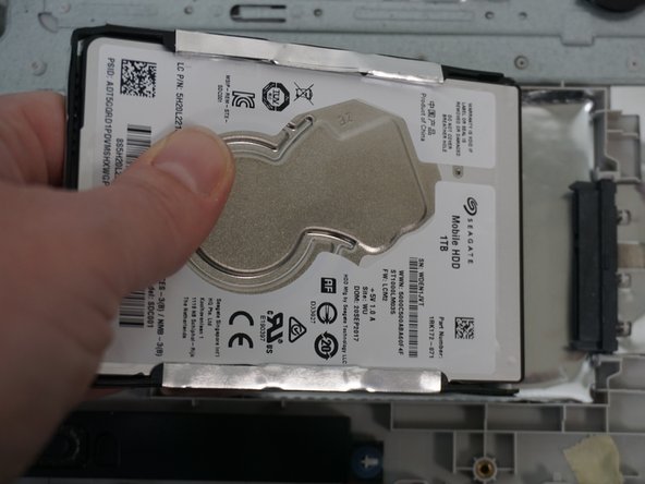

  7. Lenovo Ideapad 320-17IKB Hard Drive Replacement, Hard Drive: crwdns2935265:07crwdnd2935265:01crwdnd2935265:03crwdne2935265:0 Lenovo Ideapad 320-17IKB Hard Drive Replacement, Hard Drive: crwdns2935265:07crwdnd2935265:02crwdnd2935265:03crwdne2935265:0 Lenovo Ideapad 320-17IKB Hard Drive Replacement, Hard Drive: crwdns2935265:07crwdnd2935265:03crwdnd2935265:03crwdne2935265:0
    • Disconnect the hard drive from the SATA slot by gently pulling the hard drive to the left.

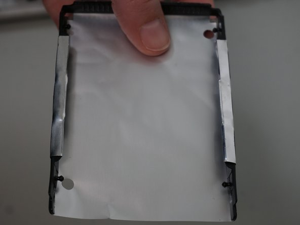

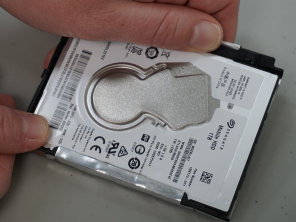

  8. Lenovo Ideapad 320-17IKB Hard Drive Replacement: crwdns2935265:08crwdnd2935265:01crwdnd2935265:03crwdne2935265:0 Lenovo Ideapad 320-17IKB Hard Drive Replacement: crwdns2935265:08crwdnd2935265:02crwdnd2935265:03crwdne2935265:0 Lenovo Ideapad 320-17IKB Hard Drive Replacement: crwdns2935265:08crwdnd2935265:03crwdnd2935265:03crwdne2935265:0
    • Use your hands to gently pull the edges at each corner away from the hard drive to remove the hard drive adapter.
