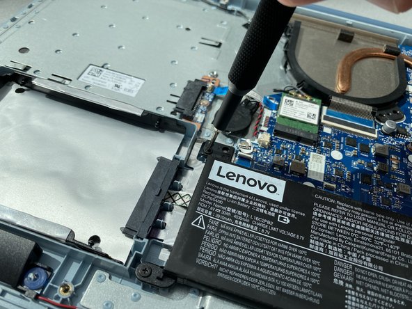

  4. Lenovo Ideapad 320-15IAP Battery Replacement: crwdns2935265:04crwdnd2935265:01crwdnd2935265:02crwdne2935265:0 Lenovo Ideapad 320-15IAP Battery Replacement: crwdns2935265:04crwdnd2935265:02crwdnd2935265:02crwdne2935265:0
    • Using a Phillips #0 screwdriver to unscrew the four 5.5 mm screws securing the battery.

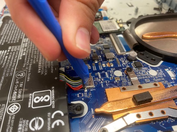

  5. Lenovo Ideapad 320-15IAP Battery Replacement: crwdns2935265:05crwdnd2935265:01crwdnd2935265:02crwdne2935265:0 Lenovo Ideapad 320-15IAP Battery Replacement: crwdns2935265:05crwdnd2935265:02crwdnd2935265:02crwdne2935265:0
    • Disconnect the battery cable from its motherboard socket by gently pulling it towards the battery.
    • Pull parallel to the battery, not straight up.
