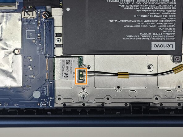

  7. Lenovo IdeaPad Slim 3 Chromebook 14M868 Display Assembly Replacement, Wi-Fi Card: crwdns2935265:07crwdnd2935265:01crwdnd2935265:02crwdne2935265:0 Lenovo IdeaPad Slim 3 Chromebook 14M868 Display Assembly Replacement, Wi-Fi Card: crwdns2935265:07crwdnd2935265:02crwdnd2935265:02crwdne2935265:0
    • Remove 1 Phillip screws.
    • Disconnect the coaxial cables from the Wi-Fi card.
  8. Lenovo IdeaPad Slim 3 Chromebook 14M868 Display Assembly Replacement: crwdns2935265:08crwdnd2935265:01crwdnd2935265:01crwdne2935265:0
    • Gently remove Wi-Fi Card by pulling away from the motherboard.
