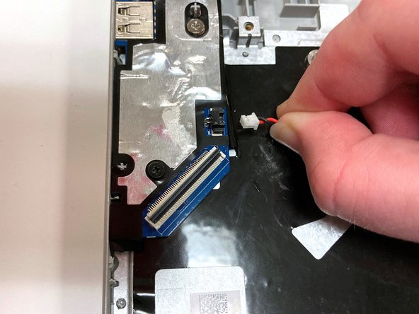

  4. Lenovo IdeaPad S340-15IWL CMOS Battery Replacement: crwdns2935265:04crwdnd2935265:01crwdnd2935265:02crwdne2935265:0 Lenovo IdeaPad S340-15IWL CMOS Battery Replacement: crwdns2935265:04crwdnd2935265:02crwdnd2935265:02crwdne2935265:0
    • Unplug the bundled red and black wires connecting the CMOS battery to the side of the device.
    • Remove the CMOS battery from the laptop.
