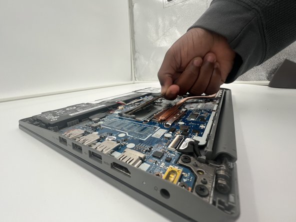

    • Use a Phillips #0 screwdriver to remove the ten screws that secure the lower case.
    • Insert an opening tool into the gap between the lower case and chassis.
    • Pry around the perimeter of the device until the lower case fully releases.
    • Remove the lower case.
  2. Lenovo IdeaPad S145-14IWL RAM Replacement, Lenovo IdeaPad S145-14IWL Battery Disconnection: crwdns2935265:02crwdnd2935265:01crwdnd2935265:01crwdne2935265:0
    • Use angled tweezers to gently pull the battery connector directly out of its socket.

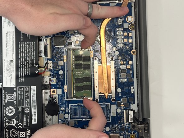

  3. Lenovo IdeaPad S145-14IWL RAM Replacement, RAM: crwdns2935265:03crwdnd2935265:01crwdnd2935265:03crwdne2935265:0 Lenovo IdeaPad S145-14IWL RAM Replacement, RAM: crwdns2935265:03crwdnd2935265:02crwdnd2935265:03crwdne2935265:0 Lenovo IdeaPad S145-14IWL RAM Replacement, RAM: crwdns2935265:03crwdnd2935265:03crwdnd2935265:03crwdne2935265:0
    • Two clips secure each RAM module in place, one on each side. Using your fingers, spread the clips away from the RAM module.
    • The RAM module will flip up slightly; this is normal.
    • Pull the RAM module directly out of its socket.
