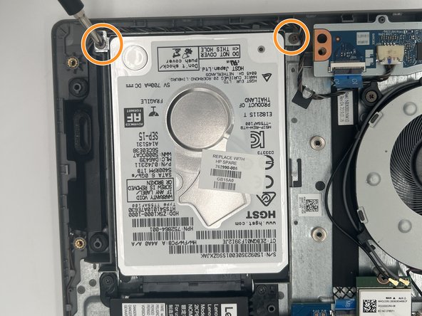

  4. Lenovo IdeaPad S145-14IWL Hard Drive Replacement, Hard Drive: crwdns2935265:04crwdnd2935265:01crwdnd2935265:03crwdne2935265:0 Lenovo IdeaPad S145-14IWL Hard Drive Replacement, Hard Drive: crwdns2935265:04crwdnd2935265:02crwdnd2935265:03crwdne2935265:0 Lenovo IdeaPad S145-14IWL Hard Drive Replacement, Hard Drive: crwdns2935265:04crwdnd2935265:03crwdnd2935265:03crwdne2935265:0

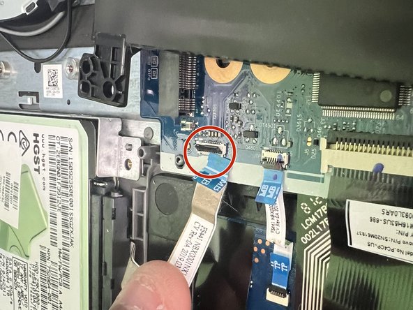

    • Flip up the black ZIF locking flap that secures the hard drive ribbon cable.
    • Disconnect the ribbon cable.
    • Use a Phillips screwdriver to remove the screws that secure the hard drive.
    • Remove the hard drive.
