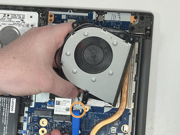

    • Use a Phillips #0 screwdriver to remove the three screws that secure the fan.
    • Use an opening tool or your fingernails to gently disconnect the fan connector from its socket.

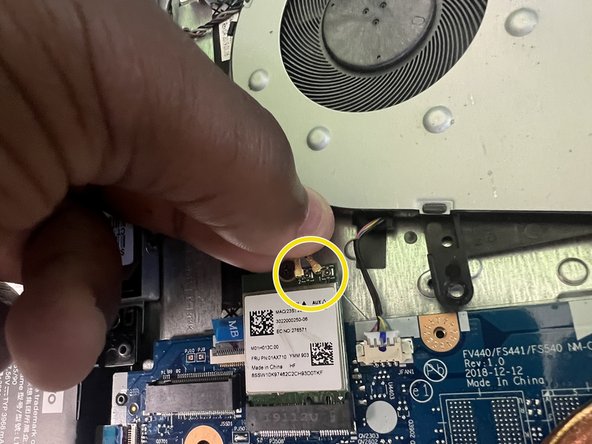

    • Use an opening tool to gently lift and disconnect the two Wi-Fi card antenna cables.
    • Lift the fan up and out of the chassis.
