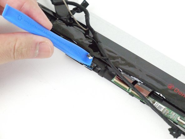

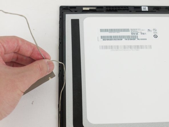

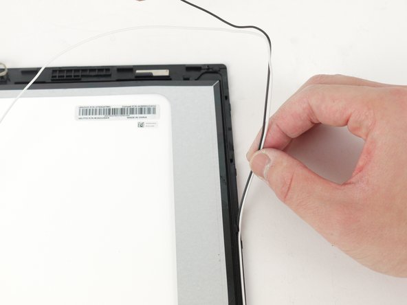

  29. Lenovo IdeaPad Flex 5-1570 Webcam Replacement, Webcam: crwdns2935265:029crwdnd2935265:01crwdnd2935265:03crwdne2935265:0 Lenovo IdeaPad Flex 5-1570 Webcam Replacement, Webcam: crwdns2935265:029crwdnd2935265:02crwdnd2935265:03crwdne2935265:0 Lenovo IdeaPad Flex 5-1570 Webcam Replacement, Webcam: crwdns2935265:029crwdnd2935265:03crwdnd2935265:03crwdne2935265:0
    • Flip the screen over so that the backside of the screen is facing you.
    • Remove the tape covering the webcam and disconnect the webcam from the screen.
    • Unravel the cables along the left and right sides of the screen.

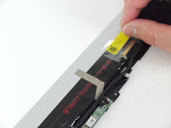

  30. Lenovo IdeaPad Flex 5-1570 Webcam Replacement: crwdns2935265:030crwdnd2935265:01crwdnd2935265:01crwdne2935265:0
    • Using a spudger, remove the yellow tape on the bottom right corner of the screen.
  31. Lenovo IdeaPad Flex 5-1570 Webcam Replacement: crwdns2935265:031crwdnd2935265:01crwdnd2935265:01crwdne2935265:0
    • Remove the yellow tape using your fingers or a plastic opening tool.
  32. Lenovo IdeaPad Flex 5-1570 Webcam Replacement: crwdns2935265:032crwdnd2935265:01crwdnd2935265:01crwdne2935265:0
    • Using the plastic opening tool, remove the black tape from the device.

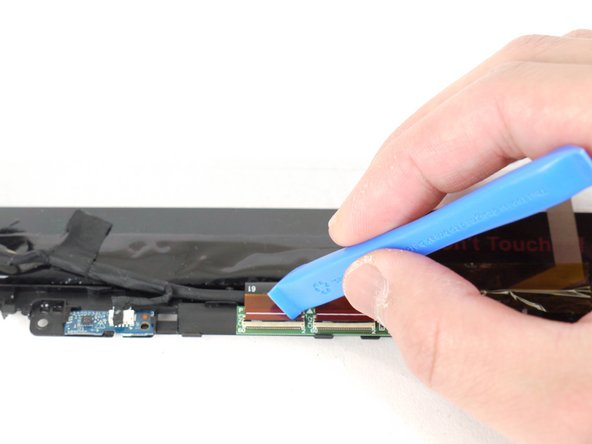

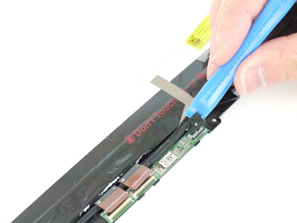

  33. Lenovo IdeaPad Flex 5-1570 Webcam Replacement: crwdns2935265:033crwdnd2935265:01crwdnd2935265:02crwdne2935265:0 Lenovo IdeaPad Flex 5-1570 Webcam Replacement: crwdns2935265:033crwdnd2935265:02crwdnd2935265:02crwdne2935265:0
    • Using the same tool, unlock the ZIF connectors and disconnect the flat cables.
  34. Lenovo IdeaPad Flex 5-1570 Webcam Replacement: crwdns2935265:034crwdnd2935265:01crwdnd2935265:02crwdne2935265:0 Lenovo IdeaPad Flex 5-1570 Webcam Replacement: crwdns2935265:034crwdnd2935265:02crwdnd2935265:02crwdne2935265:0
    • Using the plastic opening tool, disconnect the cable from panel.

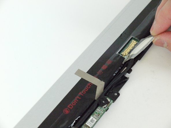

  35. Lenovo IdeaPad Flex 5-1570 Webcam Replacement: crwdns2935265:035crwdnd2935265:01crwdnd2935265:03crwdne2935265:0 Lenovo IdeaPad Flex 5-1570 Webcam Replacement: crwdns2935265:035crwdnd2935265:02crwdnd2935265:03crwdne2935265:0 Lenovo IdeaPad Flex 5-1570 Webcam Replacement: crwdns2935265:035crwdnd2935265:03crwdnd2935265:03crwdne2935265:0
    • Use the plastic opening tool to get under the piece of tape connecting the webcam cable to the display assembly.
    • Grip the piece of tape with your fingers and pull it away to disconnect the cable.
  36. Lenovo IdeaPad Flex 5-1570 Webcam Replacement: crwdns2935265:036crwdnd2935265:01crwdnd2935265:02crwdne2935265:0 Lenovo IdeaPad Flex 5-1570 Webcam Replacement: crwdns2935265:036crwdnd2935265:02crwdnd2935265:02crwdne2935265:0
    • Disconnect the webcam and remove it from the device.
