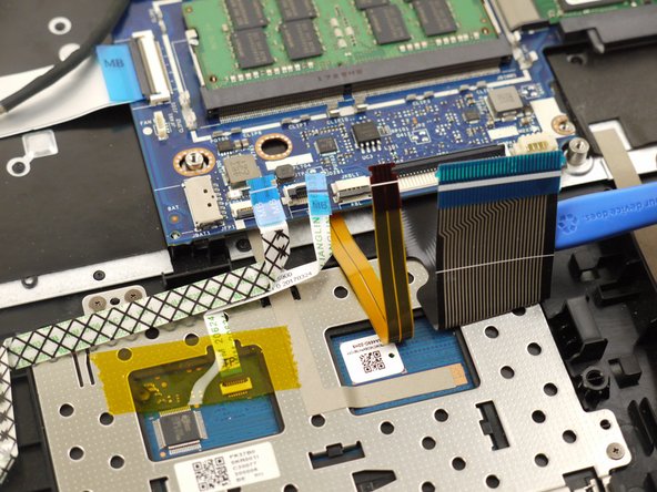

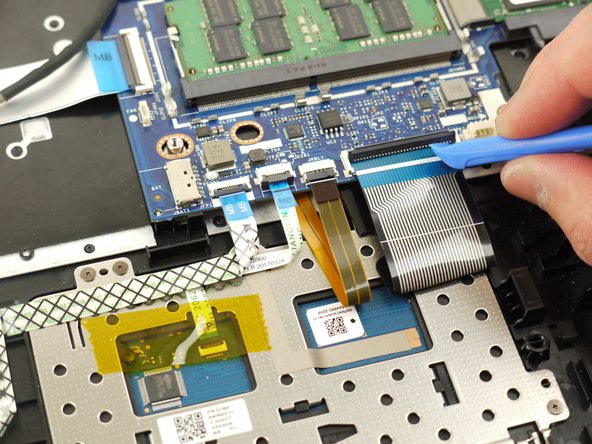

  6. Lenovo IdeaPad Flex 5-1570 Touchpad Replacement, Touchpad: crwdns2935265:06crwdnd2935265:01crwdnd2935265:03crwdne2935265:0 Lenovo IdeaPad Flex 5-1570 Touchpad Replacement, Touchpad: crwdns2935265:06crwdnd2935265:02crwdnd2935265:03crwdne2935265:0 Lenovo IdeaPad Flex 5-1570 Touchpad Replacement, Touchpad: crwdns2935265:06crwdnd2935265:03crwdnd2935265:03crwdne2935265:0
    • Using the plastic opening tool, unlock the four ZIF connectors to release the flat cables.
    • Disconnect the four flat cables from the motherboard.
