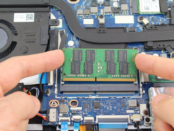

  5. Lenovo IdeaPad Flex 5-1570 RAM Replacement, RAM: crwdns2935265:05crwdnd2935265:01crwdnd2935265:03crwdne2935265:0 Lenovo IdeaPad Flex 5-1570 RAM Replacement, RAM: crwdns2935265:05crwdnd2935265:02crwdnd2935265:03crwdne2935265:0 Lenovo IdeaPad Flex 5-1570 RAM Replacement, RAM: crwdns2935265:05crwdnd2935265:03crwdnd2935265:03crwdne2935265:0
    • Push the two tabs on both sides of the RAM stick apart to release the memory module.
    • The RAM will rise up to rest at an angle to the motherboard.
  6. Lenovo IdeaPad Flex 5-1570 RAM Replacement: crwdns2935265:06crwdnd2935265:01crwdnd2935265:03crwdne2935265:0 Lenovo IdeaPad Flex 5-1570 RAM Replacement: crwdns2935265:06crwdnd2935265:02crwdnd2935265:03crwdne2935265:0 Lenovo IdeaPad Flex 5-1570 RAM Replacement: crwdns2935265:06crwdnd2935265:03crwdnd2935265:03crwdne2935265:0
    • Pull the RAM stick out of its port with respect to the angle at which it rests.
    • Be sure to handle the edges of the RAM card, as the oil on your skin can have damaging effects to the circuits or pins.

Please suggest what DDR4 RAM I should buy to replace it. I have a 16 GB, I want to go 32 or 64.
Maulik Darji - crwdns2934203:0crwdne2934203:0
"Patriot Viper Steel DDR4 32GB 2400MHz CL15 SODIMM Memory Module PVS432G240C5S" works on mine
