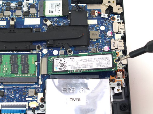

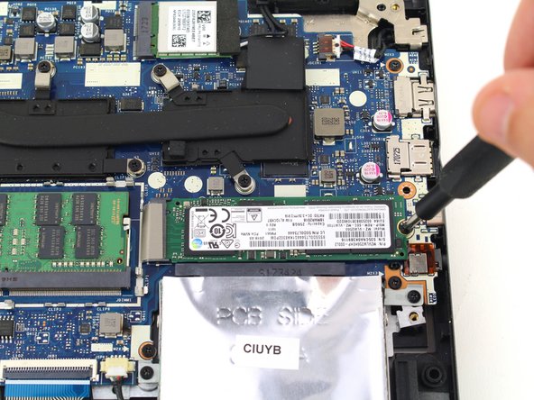

  5. Lenovo IdeaPad Flex 5-1570 M.2 SSD Replacement, M.2 SSD: crwdns2935265:05crwdnd2935265:01crwdnd2935265:03crwdne2935265:0 Lenovo IdeaPad Flex 5-1570 M.2 SSD Replacement, M.2 SSD: crwdns2935265:05crwdnd2935265:02crwdnd2935265:03crwdne2935265:0 Lenovo IdeaPad Flex 5-1570 M.2 SSD Replacement, M.2 SSD: crwdns2935265:05crwdnd2935265:03crwdnd2935265:03crwdne2935265:0
    • Remove the single 2.9 mm screw holding down the solid state drive with a Phillips #0 screwdriver.
    • The SSD will rise to rest at an angle once the screw is removed.
  6. Lenovo IdeaPad Flex 5-1570 M.2 SSD Replacement: crwdns2935265:06crwdnd2935265:01crwdnd2935265:03crwdne2935265:0 Lenovo IdeaPad Flex 5-1570 M.2 SSD Replacement: crwdns2935265:06crwdnd2935265:02crwdnd2935265:03crwdne2935265:0 Lenovo IdeaPad Flex 5-1570 M.2 SSD Replacement: crwdns2935265:06crwdnd2935265:03crwdnd2935265:03crwdne2935265:0
    • Pull the solid state drive out of its port to the right at a similar angle to which it rests.
    • Remove the SSD from the device.
