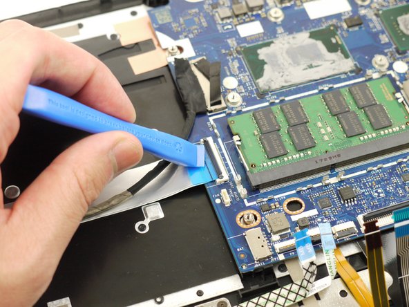

  6. Lenovo IdeaPad Flex 5-1570 Daughterboard Replacement, Daughterboard: crwdns2935265:06crwdnd2935265:01crwdnd2935265:02crwdne2935265:0 Lenovo IdeaPad Flex 5-1570 Daughterboard Replacement, Daughterboard: crwdns2935265:06crwdnd2935265:02crwdnd2935265:02crwdne2935265:0
    • Using the plastic opening tool, unlock the connector for the side ports panel and disconnect the cable from the motherboard.

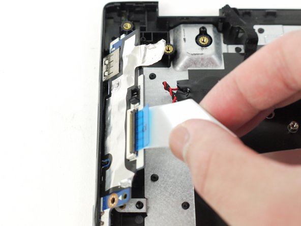

  8. Lenovo IdeaPad Flex 5-1570 Daughterboard Replacement: crwdns2935265:08crwdnd2935265:01crwdnd2935265:01crwdne2935265:0
    • Using the Phillips #00 screwdriver, remove the single 5 mm screw.
  9. Lenovo IdeaPad Flex 5-1570 Daughterboard Replacement: crwdns2935265:09crwdnd2935265:01crwdnd2935265:01crwdne2935265:0
    • Using the iFixit Opening tool, remove the silver piece of tape from the device.
  10. Lenovo IdeaPad Flex 5-1570 Daughterboard Replacement: crwdns2935265:010crwdnd2935265:01crwdnd2935265:02crwdne2935265:0 Lenovo IdeaPad Flex 5-1570 Daughterboard Replacement: crwdns2935265:010crwdnd2935265:02crwdnd2935265:02crwdne2935265:0
    • Lift the daughterboard up and out of the device.
