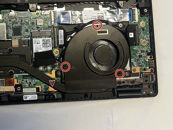

  3. Lenovo IdeaPad Flex 5 Chrome 13ITL6 Fan and Heat Sink Replacement, Fan and Heat Sink: crwdns2935265:03crwdnd2935265:01crwdnd2935265:02crwdne2935265:0 Lenovo IdeaPad Flex 5 Chrome 13ITL6 Fan and Heat Sink Replacement, Fan and Heat Sink: crwdns2935265:03crwdnd2935265:02crwdnd2935265:02crwdne2935265:0
    • Remove the three 3.2 mm screws securing the fan cover with a Phillips #000 screwdriver.

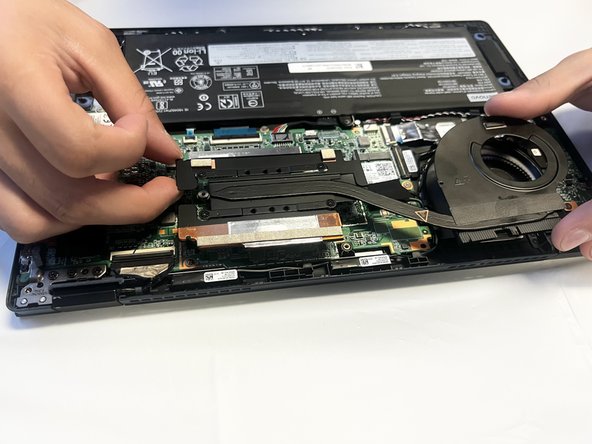

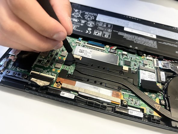

  4. Lenovo IdeaPad Flex 5 Chrome 13ITL6 Fan and Heat Sink Replacement: crwdns2935265:04crwdnd2935265:01crwdnd2935265:03crwdne2935265:0 Lenovo IdeaPad Flex 5 Chrome 13ITL6 Fan and Heat Sink Replacement: crwdns2935265:04crwdnd2935265:02crwdnd2935265:03crwdne2935265:0 Lenovo IdeaPad Flex 5 Chrome 13ITL6 Fan and Heat Sink Replacement: crwdns2935265:04crwdnd2935265:03crwdnd2935265:03crwdne2935265:0
    • Remove the four 3.6 mm screws that secure the heat sink with a Phillips #000 screwdriver.
    • Gently lift the heatsink and fan cover out.
    • You will need to reapply thermal paste before reinstalling a heatsink.

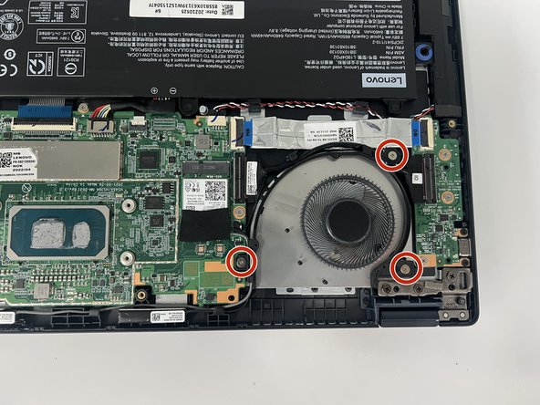

  5. Lenovo IdeaPad Flex 5 Chrome 13ITL6 Fan and Heat Sink Replacement: crwdns2935265:05crwdnd2935265:01crwdnd2935265:02crwdne2935265:0 Lenovo IdeaPad Flex 5 Chrome 13ITL6 Fan and Heat Sink Replacement: crwdns2935265:05crwdnd2935265:02crwdnd2935265:02crwdne2935265:0
    • Remove the three 2.5 mm screws securing the fan with a Phillips #000 screwdriver.

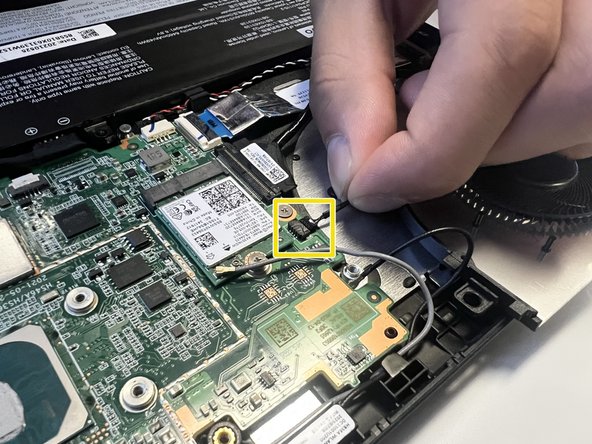

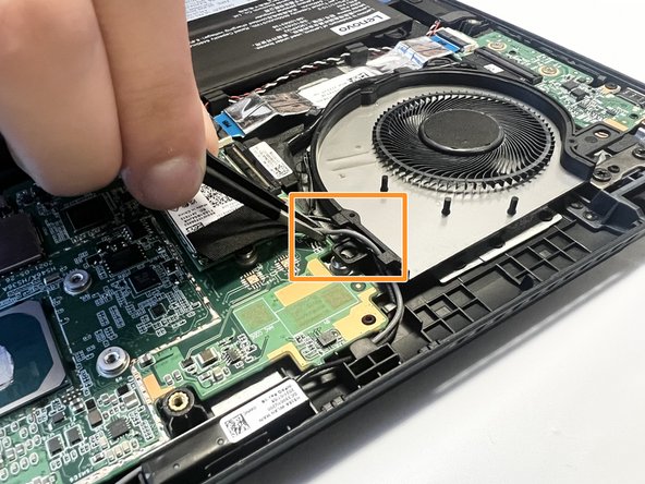

  6. Lenovo IdeaPad Flex 5 Chrome 13ITL6 Fan and Heat Sink Replacement: crwdns2935265:06crwdnd2935265:01crwdnd2935265:03crwdne2935265:0 Lenovo IdeaPad Flex 5 Chrome 13ITL6 Fan and Heat Sink Replacement: crwdns2935265:06crwdnd2935265:02crwdnd2935265:03crwdne2935265:0 Lenovo IdeaPad Flex 5 Chrome 13ITL6 Fan and Heat Sink Replacement: crwdns2935265:06crwdnd2935265:03crwdnd2935265:03crwdne2935265:0
    • Use the tweezers to guide the wire free from the fan.
    • Use the tweezers to free the grey wire from the fan.
    • Use your fingers to disconnect the fan connector from its motherboard socket.
