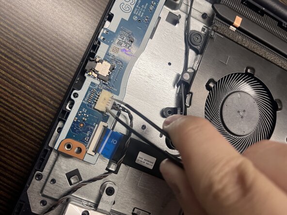

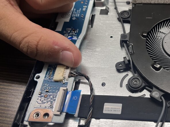

Using your fingernail or tweezers, "walk" the speaker's sliding connector out of its socket.
To reconnect the cable, align the cable and use a spudger or clean fingernail to push it fully into the socket.

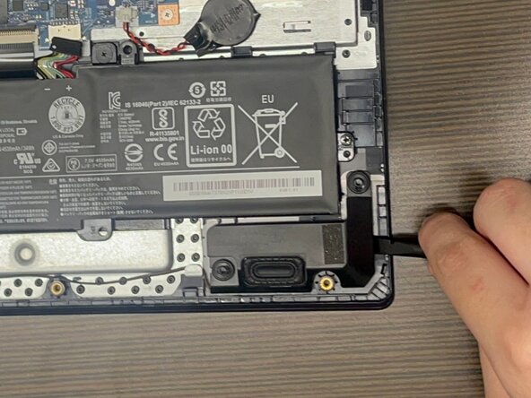

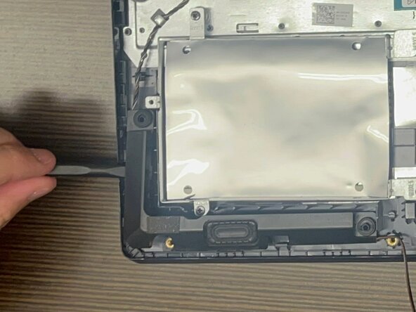

Using the spudger, pry underneath the speaker and lift it.

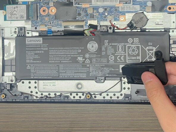

Carefully guide the speaker wire out of the plastic clips.
Lift and remove the speakers.
