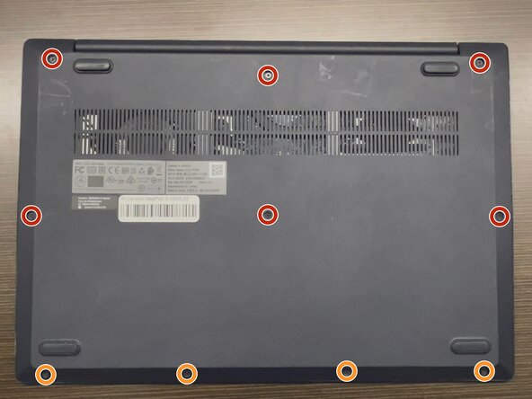

    • Use a Phillips #1 screw driver to remove:
    • Six 5.0 mm screws
    • Four 3.0 mm screws

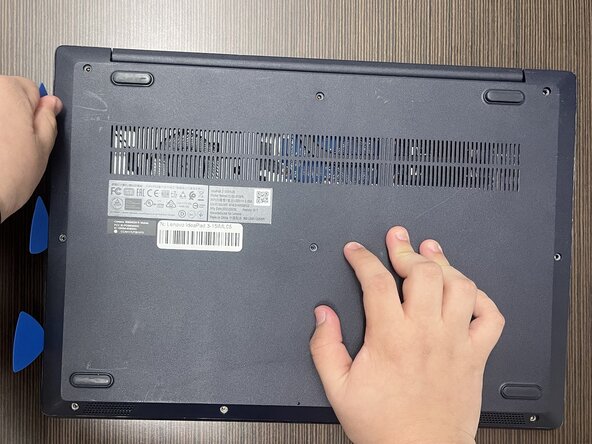

    • Use an opening tool to pry the bottom cover from the device.
    • Use the opening tool to go around the entire perimeter, releasing the tabs that secure the cover to the frame.
    • Insert opening picks between the bottom cover and the frame to prevent the case from reconnecting.
    • Carefully remove the cover.
