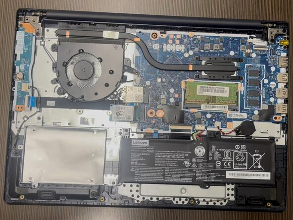

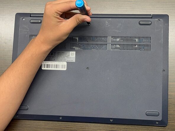

    • Before beginning, discharge the battery below 25%, power the device off, and disconnect all peripherals.
    • Use a Phillips #1 screwdriver to remove the following screws:
    • Six 7 mm screws
    • Four 4 mm screws
  2. Lenovo IdeaPad 3-15IML05 Fan Replacement: crwdns2935265:02crwdnd2935265:01crwdnd2935265:02crwdne2935265:0 Lenovo IdeaPad 3-15IML05 Fan Replacement: crwdns2935265:02crwdnd2935265:02crwdnd2935265:02crwdne2935265:0
    • Insert an opening pick into the seam between the lower case and chassis.
    • Slide the pick around the entire perimeter until all of the plastic retaining clips release.
    • Remove the lower case.
    • Forcing the back cover open could break the plastic retaining clips.
    • During reassembly, lay the cover flat and press around the edges to secure it to the plastic clips.

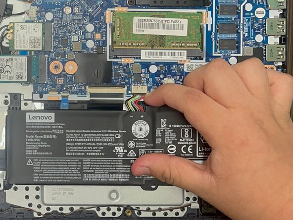

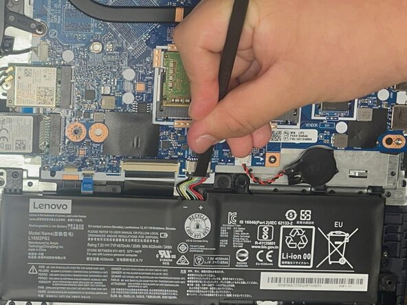

  3. Lenovo IdeaPad 3-15IML05 Fan Replacement, Lenovo IdeaPad 3-15IML05 Battery Disconnection: crwdns2935265:03crwdnd2935265:01crwdnd2935265:02crwdne2935265:0 Lenovo IdeaPad 3-15IML05 Fan Replacement, Lenovo IdeaPad 3-15IML05 Battery Disconnection: crwdns2935265:03crwdnd2935265:02crwdnd2935265:02crwdne2935265:0
    • Use a plastic spudger or your fingernail to gently push the JST battery connector out of its socket.
    • Pulling directly on the cable could damage the connector.

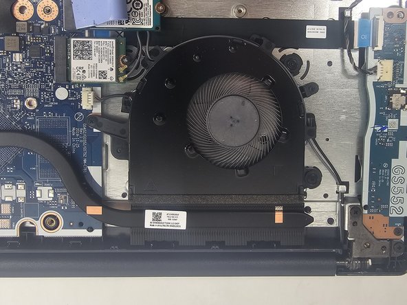

  4. Lenovo IdeaPad 3-15IML05 Fan Replacement, Fan: crwdns2935265:04crwdnd2935265:01crwdnd2935265:02crwdne2935265:0 Lenovo IdeaPad 3-15IML05 Fan Replacement, Fan: crwdns2935265:04crwdnd2935265:02crwdnd2935265:02crwdne2935265:0
    • Use a Phillips screwdriver to remove the three screws securing the fan to the chassis.

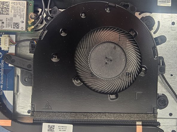

  5. Lenovo IdeaPad 3-15IML05 Fan Replacement: crwdns2935265:05crwdnd2935265:01crwdnd2935265:02crwdne2935265:0 Lenovo IdeaPad 3-15IML05 Fan Replacement: crwdns2935265:05crwdnd2935265:02crwdnd2935265:02crwdne2935265:0
    • Grip the tab at the end of the bundle cable and pull the connector slowly and steadily out of its socket to disconnect the fan cable.
    • Be careful that you do not damage the socket on the motherboard when disconnecting the fan cable.
    • Disconnect the fan from the heat sink.
    • Gently unhook the black wire from the tabs around the edge of the fan.
    • Lift the fan from the laptop to remove it.
    • If there is any resistance, double-check that the screws and connections have been removed
