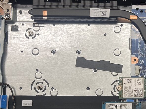

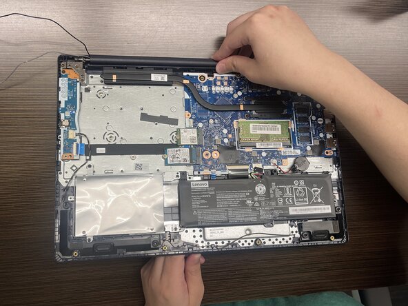

    • Before beginning, discharge the battery below 25%, power the device off, and disconnect all peripherals.
    • Use a Phillips #1 screwdriver to remove the following screws:
    • Six 7 mm screws
    • Four 4 mm screws
  2. Lenovo IdeaPad 3-15IML05 Display Assembly Replacement: crwdns2935265:02crwdnd2935265:01crwdnd2935265:02crwdne2935265:0 Lenovo IdeaPad 3-15IML05 Display Assembly Replacement: crwdns2935265:02crwdnd2935265:02crwdnd2935265:02crwdne2935265:0
    • Insert an opening pick into the seam between the lower case and chassis.
    • Slide the pick around the entire perimeter until all of the plastic retaining clips release.
    • Remove the lower case.
    • Forcing the back cover open could break the plastic retaining clips.
    • During reassembly, lay the cover flat and press around the edges to secure it to the plastic clips.

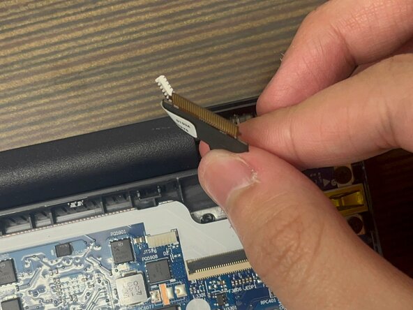

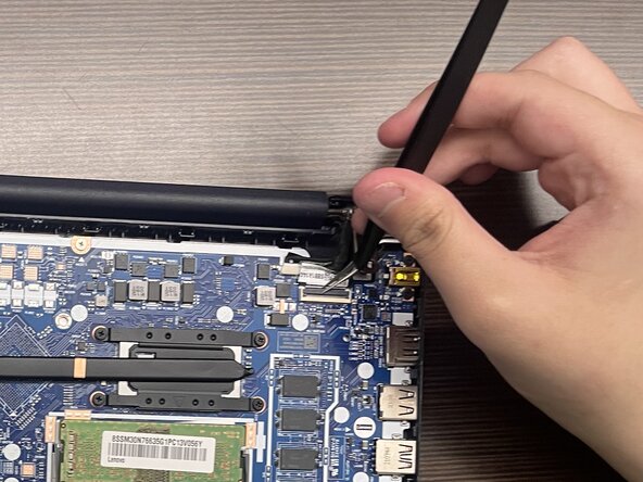

  4. Lenovo IdeaPad 3-15IML05 Display Assembly Replacement, Display Assembly: crwdns2935265:04crwdnd2935265:01crwdnd2935265:02crwdne2935265:0 Lenovo IdeaPad 3-15IML05 Display Assembly Replacement, Display Assembly: crwdns2935265:04crwdnd2935265:02crwdnd2935265:02crwdne2935265:0

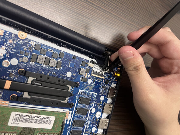

    • Using angled tweezers, flip up the black locking flap on the ZIF display cable connector.

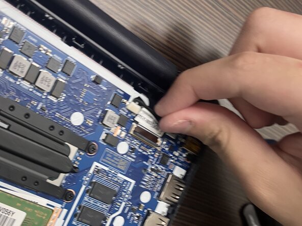

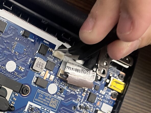

  5. Lenovo IdeaPad 3-15IML05 Display Assembly Replacement: crwdns2935265:05crwdnd2935265:01crwdnd2935265:03crwdne2935265:0 Lenovo IdeaPad 3-15IML05 Display Assembly Replacement: crwdns2935265:05crwdnd2935265:02crwdnd2935265:03crwdne2935265:0 Lenovo IdeaPad 3-15IML05 Display Assembly Replacement: crwdns2935265:05crwdnd2935265:03crwdnd2935265:03crwdne2935265:0
    • For the ZIF cable, grab the sides and gently pull it out of its socket.
    • Using tweezers, gently pull the JST cable next to the display ZIF connector out of its socket.
    • When reconnecting the ZIF cable, ensure the locking flap is up, insert the cable into the socket, and flip the locking flap down. The cable should slide in with little to no force.

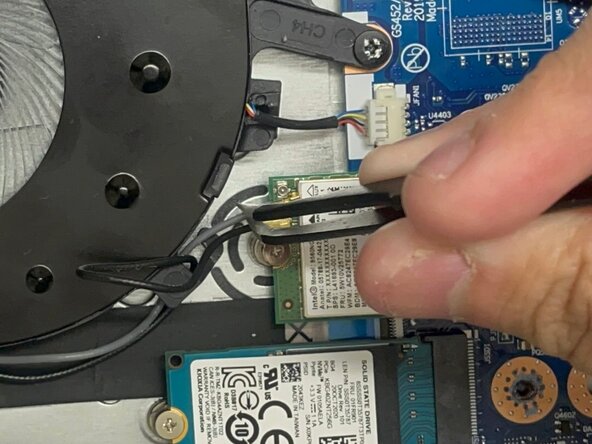

  6. Lenovo IdeaPad 3-15IML05 Display Assembly Replacement: crwdns2935265:06crwdnd2935265:01crwdnd2935265:02crwdne2935265:0 Lenovo IdeaPad 3-15IML05 Display Assembly Replacement: crwdns2935265:06crwdnd2935265:02crwdnd2935265:02crwdne2935265:0

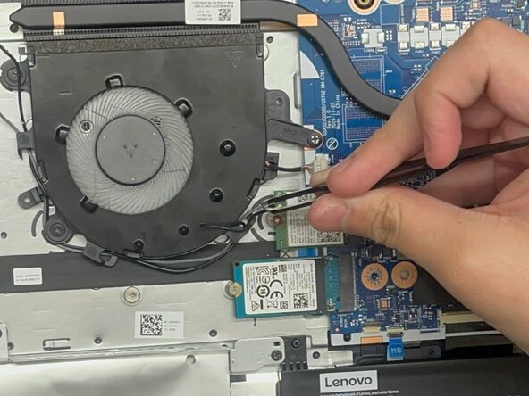

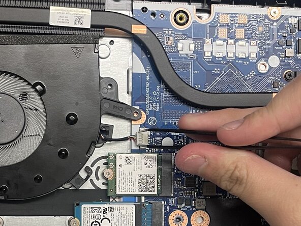

    • Using angled tweezers, slide them under the metal neck of the Wi-Fi card antenna cables, and lift straight up to disconnect them.
    • Lifting at angle could damage the socket underneath the board.
    • When reconnecting the antenna cables, hold the cable with tweezers and gently press with your finger or a spudger. They should snap into place, however this might take a few tries.
    • Don't force the connector into place or you might permanently damage it.
    • Guide the cables out from the plastic clips on the edge of the fan.
    • If you're unable to guide the cables out, go to the next step.

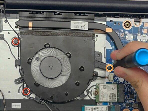

    • If you were unable to remove the antenna cables from the clips, then proceed with this step.
    • Using tweezers, gently pull the JST fan cable out of its socket.
    • Use a Phillips #00 screwdriver to remove the following screws:
    • Two 3.5 mm screws
    • One 5 mm screw
    • Lift the fan and guide the antenna cables out of the clips on its edge.

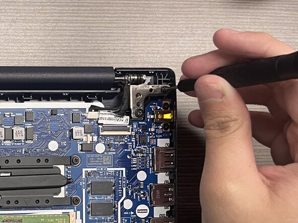

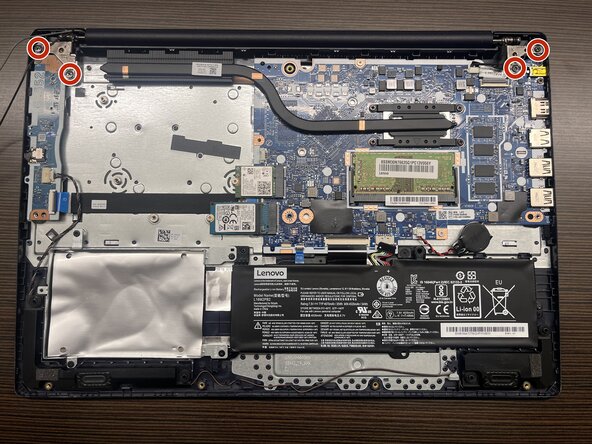

    • Use a Philips #00 screwdriver to remove the four 5 mm screws that secure the hinges.

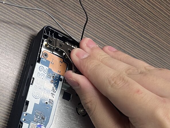

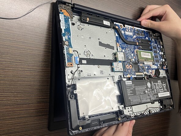

    • With one hand holding the back, slowly raise the display with the other hand.
    • Grasp and open both hinges until they're straight.
    • Keep these straight up until the new display is installed. Then, lower and secure the display.

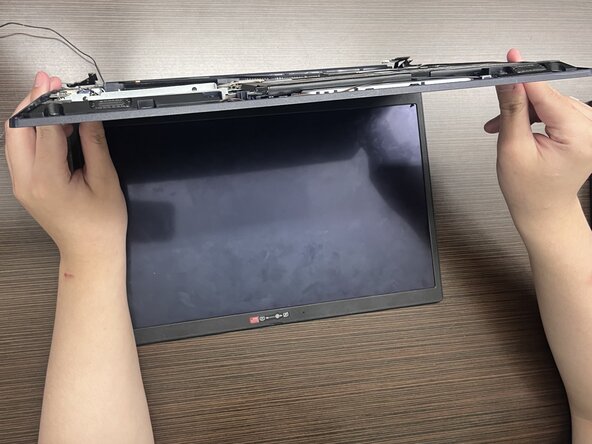

  10. Lenovo IdeaPad 3-15IML05 Display Assembly Replacement: crwdns2935265:010crwdnd2935265:01crwdnd2935265:02crwdne2935265:0 Lenovo IdeaPad 3-15IML05 Display Assembly Replacement: crwdns2935265:010crwdnd2935265:02crwdnd2935265:02crwdne2935265:0

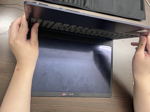

    • Lift the top cover until it's straight up.
    • Pull the cover towards you to separate it from the display.
